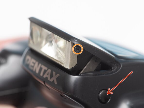

  1. Pentax PZ-1p Top Cover Removal, Remove flash cover: crwdns2935265:01crwdnd2935265:01crwdnd2935265:03crwdne2935265:0 Pentax PZ-1p Top Cover Removal, Remove flash cover: crwdns2935265:01crwdnd2935265:02crwdnd2935265:03crwdne2935265:0 Pentax PZ-1p Top Cover Removal, Remove flash cover: crwdns2935265:01crwdnd2935265:03crwdnd2935265:03crwdne2935265:0
    • Push button to pop up the flash.
    • Remove two 1.7 x 2.5 mm screws.
    • Detach snaps by lifting the side of the flash cover, bending it up and away from the housing.
    • Push flash back down to the stored position.

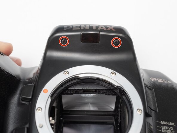

  2. Pentax PZ-1p Top Cover Removal, Remove top cover screws: crwdns2935265:02crwdnd2935265:01crwdnd2935265:03crwdne2935265:0 Pentax PZ-1p Top Cover Removal, Remove top cover screws: crwdns2935265:02crwdnd2935265:02crwdnd2935265:03crwdne2935265:0 Pentax PZ-1p Top Cover Removal, Remove top cover screws: crwdns2935265:02crwdnd2935265:03crwdnd2935265:03crwdne2935265:0
    • Remove two 1.7 x 2.5 mm screws underneath the pop-up flash.
    • Remove one 1.7 x 2.5 mm panhead screw above the pop-up flash.
    • Remove two 1.7 x 2.5 mm shoulder screws near the eye piece.
