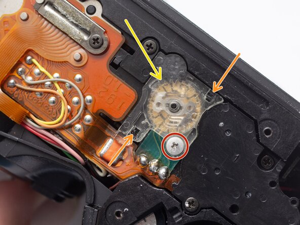

  3. Pentax PZ-1p Sprocket Counter PCB Replacement, Remove sprocket counter cover: crwdns2935265:03crwdnd2935265:01crwdnd2935265:01crwdne2935265:0
    • Remove one screw. This screw is unusual because it has a very steep thread pitch and will want to back out with very little rotation.
    • Use tweezers or a pick to unhook two snaps.
    • Work the cover free. It's a tight fit and will require some wiggling.
    • Installation Notes: Make sure that the sprocket shaft in the film chamber is in the correct position. When the sprocket shaft spins, the sprocket counter should turn as well.

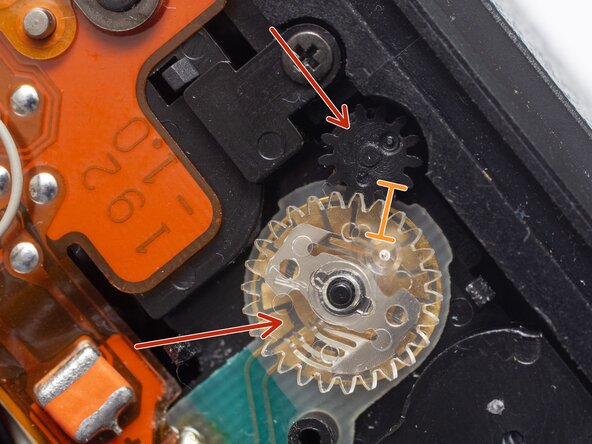

  4. Pentax PZ-1p Sprocket Counter PCB Replacement, Remove gears: crwdns2935265:04crwdnd2935265:01crwdnd2935265:01crwdne2935265:0
    • Remove two gears.
    • The clear gear has delicate contacts on the underside. Be careful not to deform them.
    • Installation Notes: Align the dots on each gear when reinstalling.

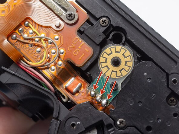

  5. Pentax PZ-1p Sprocket Counter PCB Replacement, Remove sprocket counter PCB: crwdns2935265:05crwdnd2935265:01crwdnd2935265:01crwdne2935265:0
    • Unsolder three flex connections.
    • Remove the sprocket counter PCB.
