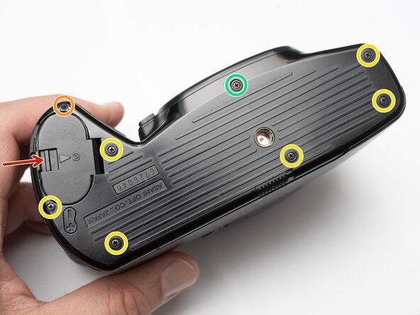

  1. Pentax PZ-1p Body Panel Removal, Remove bottom cover: crwdns2935265:01crwdnd2935265:01crwdnd2935265:03crwdne2935265:0 Pentax PZ-1p Body Panel Removal, Remove bottom cover: crwdns2935265:01crwdnd2935265:02crwdnd2935265:03crwdne2935265:0 Pentax PZ-1p Body Panel Removal, Remove bottom cover: crwdns2935265:01crwdnd2935265:03crwdnd2935265:03crwdne2935265:0
    • Unlatch battery compartment door.
    • Remove one 1.7 x 4.0 mm screw.
    • Remove six 1.7 x 2.5 mm shoulder screws.
    • Remove one 1.7 x 2.5 mm long shoulder screw.
    • The bottom cover may be adhered with double sided tape in some locations. Use a spudger to gently work it loose.

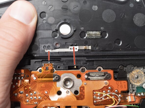

  2. Pentax PZ-1p Body Panel Removal, Installation Notes: Bottom cover: crwdns2935265:02crwdnd2935265:01crwdnd2935265:01crwdne2935265:0
    • Check that the physical panorama switch on the bottom cover and the electrical switch mate properly.
