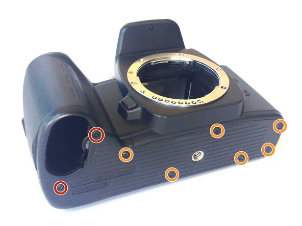

  1. Pentax PZ-10 Back Cover Locking Switch Spring Replacement, Removing the Bottom Cover: crwdns2935265:01crwdnd2935265:01crwdnd2935265:01crwdne2935265:0
    • With the lens face up and the bottom panel of the camera facing you, remove the two 7mm screws on the left using the J0 screwdriver.
    • Remove the six 4.3mm screws in the middle and right of the panel using the J0 screwdriver.
    • Pull off the bottom casing to remove.

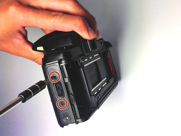

  3. Pentax PZ-10 Back Cover Locking Switch Spring Replacement, Removing the Back Cover: crwdns2935265:03crwdnd2935265:01crwdnd2935265:01crwdne2935265:0
    • Place the camera on its side so the lens is facing left.
    • Press down on the locking switch on the side panel facing you.
  4. Pentax PZ-10 Back Cover Locking Switch Spring Replacement: crwdns2935265:04crwdnd2935265:01crwdnd2935265:01crwdne2935265:0

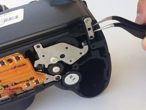

  5. Pentax PZ-10 Back Cover Locking Switch Spring Replacement: crwdns2935265:05crwdnd2935265:01crwdnd2935265:01crwdne2935265:0
    • Using a pair of tweezers, gently remove the metal tab securing the back door axle.
    • The door will come loose at this point, watch for any loose parts that may also come out.

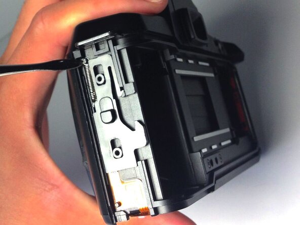

  7. Pentax PZ-10 Back Cover Locking Switch Spring Replacement, Removing the Spring: crwdns2935265:07crwdnd2935265:01crwdnd2935265:01crwdne2935265:0
    • Locate the spring at the upper left corner of the face, and pull the rings of the spring off of the pins to remove it using plastic opening tools.
    • You are now ready to replace the spring.
