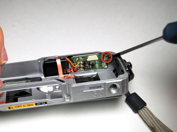

  8. Pentax Optio WP Shutter and Power Buttons Replacement, Shutter and Power Buttons: crwdns2935265:08crwdnd2935265:01crwdnd2935265:02crwdne2935265:0 Pentax Optio WP Shutter and Power Buttons Replacement, Shutter and Power Buttons: crwdns2935265:08crwdnd2935265:02crwdnd2935265:02crwdne2935265:0
    • Lay front casing flat on surface as if you are looking through the camera lens.
    • Remove the 4.3 mm silver screw in the upper right hand corner of the casing near the shutter and power button.

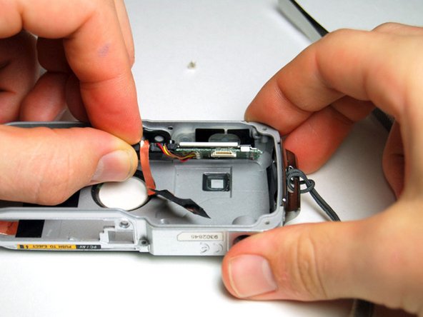

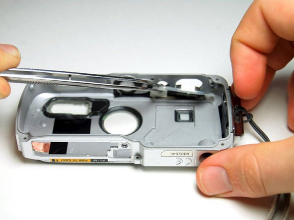

  9. Pentax Optio WP Shutter and Power Buttons Replacement: crwdns2935265:09crwdnd2935265:01crwdnd2935265:03crwdne2935265:0 Pentax Optio WP Shutter and Power Buttons Replacement: crwdns2935265:09crwdnd2935265:02crwdnd2935265:03crwdne2935265:0 Pentax Optio WP Shutter and Power Buttons Replacement: crwdns2935265:09crwdnd2935265:03crwdnd2935265:03crwdne2935265:0
    • Use the tweezers to remove the black plastic and attached copper ribbon on the inside of the casing.
    • Use your hand to pry off the circuit board for the shutter and power buttons.
    • Remove the shutter and power buttons with the tweezers.
