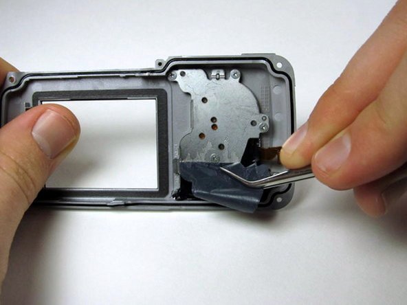

  7. Pentax Optio WP Back Buttons Replacement, Back Buttons: crwdns2935265:07crwdnd2935265:01crwdnd2935265:02crwdne2935265:0 Pentax Optio WP Back Buttons Replacement, Back Buttons: crwdns2935265:07crwdnd2935265:02crwdnd2935265:02crwdne2935265:0
    • When the back casing is removed, orient it so that you are looking at the interior of the back casing. Make sure the glass case of the LCD screen is on the left hand side.
    • Peel back the black sticky film on the right side to reveal six screws.
  8. Pentax Optio WP Back Buttons Replacement: crwdns2935265:08crwdnd2935265:01crwdnd2935265:01crwdne2935265:0
    • For ease of access, orient the casing so the screws are now on the left side.
    • Remove the six 4.3 mm screws holding the back buttons to the back casing.

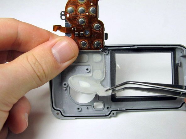

  9. Pentax Optio WP Back Buttons Replacement: crwdns2935265:09crwdnd2935265:01crwdnd2935265:02crwdne2935265:0 Pentax Optio WP Back Buttons Replacement: crwdns2935265:09crwdnd2935265:02crwdnd2935265:02crwdne2935265:0
    • Flip the metal casing up to reveal the back buttons.
    • Use the tweezers to remove the back buttons.
