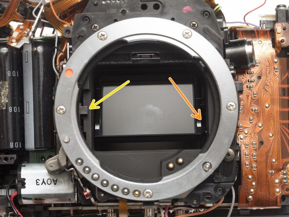

  24. Pentax MZ-S Mirror Drive Lever Replacement, Flip the mirror up: crwdns2935265:024crwdnd2935265:01crwdnd2935265:02crwdne2935265:0 Pentax MZ-S Mirror Drive Lever Replacement, Flip the mirror up: crwdns2935265:024crwdnd2935265:02crwdnd2935265:02crwdne2935265:0
    • Rotate the black gear downward until the mirror flips up into the taking position. It may take several turns.
    • Some failures will result in the mirror appearing to be in the upper position but the internal mechanism is still "down". The mechanism needs to be moved to release the mirror box.
