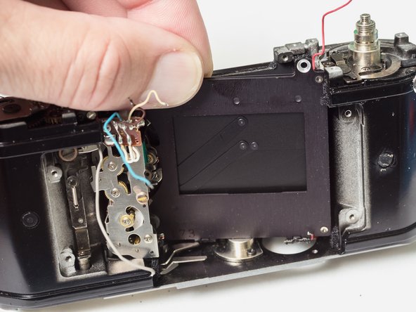

    10. Pentax ME Super Shutter Service, Remove front block assembly: crwdns2935265:017crwdnd2935265:01crwdnd2935265:02crwdne2935265:0 Pentax ME Super Shutter Service, Remove front block assembly: crwdns2935265:017crwdnd2935265:02crwdnd2935265:02crwdne2935265:0
      • Temporarily replace the advance lever and cock the shutter.
      • Gently lift the front block away from the camera body. Move slowly and look for wire snags.
    11. Pentax ME Super Shutter Service, Installation Notes: Front Block: crwdns2935265:018crwdnd2935265:01crwdnd2935265:01crwdne2935265:0
      • Cock the shutter on the camera body. The mirror box should be uncharged before installation.
      • Twist the three motor drive wires together to easily insert them through the bottom of the camera.
      • Carefully track wire routing during installation. Make sure nothing is getting pinched and that all wires are accessible for resoldering.
      • Once the front block is in place, check the mechanical speeds of the shutter before completing the reassembly. The mirror and shutter should function normally.

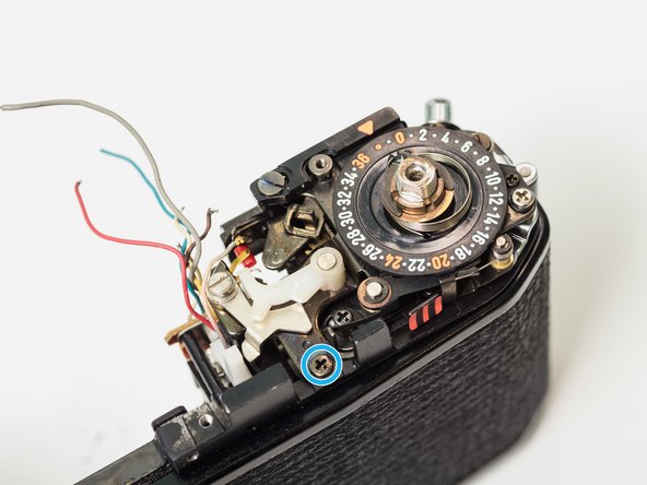

    2. Pentax ME Super Shutter Service, Remove shutter cocked indicator: crwdns2935265:020crwdnd2935265:01crwdnd2935265:01crwdne2935265:0
      • Remove one 6.3 mm flat head screw.
      • Remove the shutter cocked indicator.

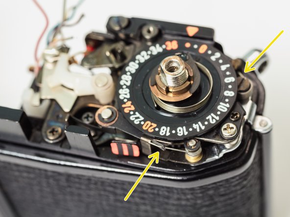

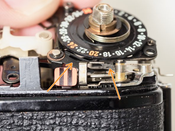

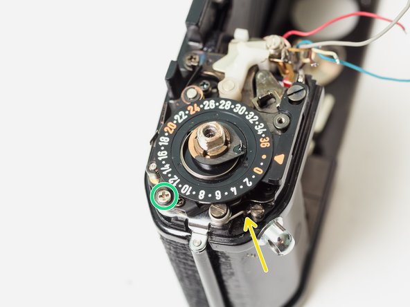

    3. Pentax ME Super Shutter Service, Remove frame counter assembly: crwdns2935265:021crwdnd2935265:01crwdnd2935265:03crwdne2935265:0 Pentax ME Super Shutter Service, Remove frame counter assembly: crwdns2935265:021crwdnd2935265:02crwdnd2935265:03crwdne2935265:0 Pentax ME Super Shutter Service, Remove frame counter assembly: crwdns2935265:021crwdnd2935265:03crwdnd2935265:03crwdne2935265:0
      • Remove one 5.1 mm flat head screw.
      • Remove frame number indicator.
      • Unhook spring.
      • Remove one 3.9 mm #00 screw.
      • Remove one 3.0 mm #00 screw.
      • Carefully remove frame counter assembly.
    4. Pentax ME Super Shutter Service, Installation Notes: Frame counter assembly: crwdns2935265:022crwdnd2935265:01crwdnd2935265:03crwdne2935265:0 Pentax ME Super Shutter Service, Installation Notes: Frame counter assembly: crwdns2935265:022crwdnd2935265:02crwdnd2935265:03crwdne2935265:0 Pentax ME Super Shutter Service, Installation Notes: Frame counter assembly: crwdns2935265:022crwdnd2935265:03crwdnd2935265:03crwdne2935265:0
      • Make sure the silver cam is fully inserted and in the correct position.
      • Insert these levers first. Then gently work the rest of the assembly into place.
      • Make sure the bias springs are placed properly.

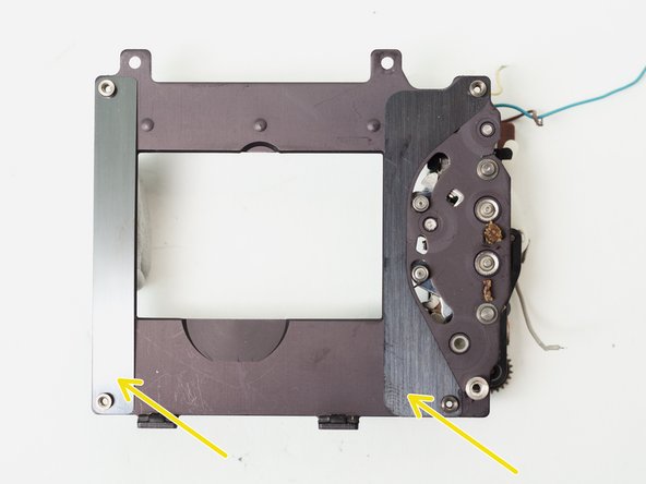

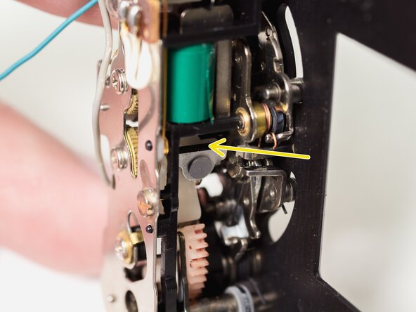

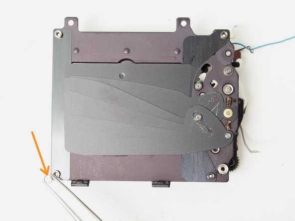

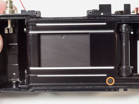

    5. Pentax ME Super Shutter Service, Remove shutter block: crwdns2935265:023crwdnd2935265:01crwdnd2935265:03crwdne2935265:0 Pentax ME Super Shutter Service, Remove shutter block: crwdns2935265:023crwdnd2935265:02crwdnd2935265:03crwdne2935265:0 Pentax ME Super Shutter Service, Remove shutter block: crwdns2935265:023crwdnd2935265:03crwdnd2935265:03crwdne2935265:0
      • Remove shutter light seal.
      • Remove three 3.4 mm #00 screws.
      • Swing the right side of the shutter forward, then lift out.
      • Cock the shutter by pushing the lever on the bottom to the left.
      • Push the shutter release on the bottom of the shutter begin the exposure.
      • Push the white plastic lever to the right release the closing curtain.
      • Hold the white plastic lever to the right to operate the shutter at its mechanical speed, 1/125.
      • The shutter should be in its released state for disassembly.

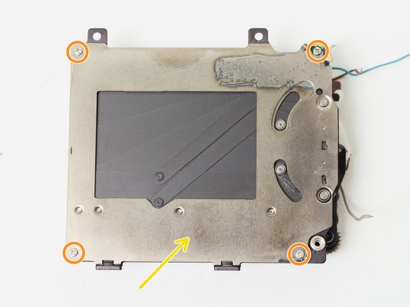

    6. Pentax ME Super Shutter Service, Remove shutter back plate: crwdns2935265:025crwdnd2935265:01crwdnd2935265:03crwdne2935265:0 Pentax ME Super Shutter Service, Remove shutter back plate: crwdns2935265:025crwdnd2935265:02crwdnd2935265:03crwdne2935265:0 Pentax ME Super Shutter Service, Remove shutter back plate: crwdns2935265:025crwdnd2935265:03crwdnd2935265:03crwdne2935265:0
      • Peel off two foam light seals.
      • Remove four 2.3 mm #000 screws.
      • Remove back plate.
      • Remove top spacer.
      • Installation Notes: The light seal foam should be replaced with new foam during reassembly.

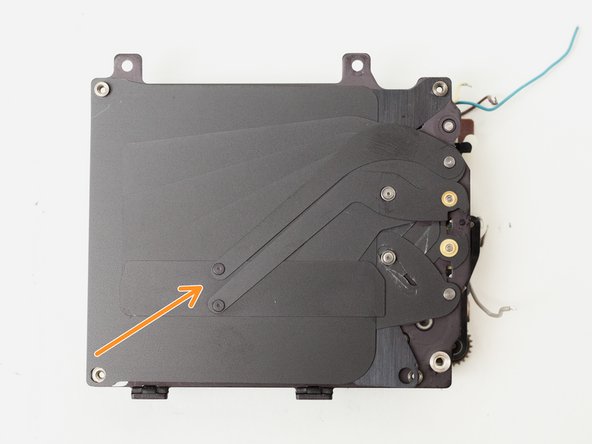

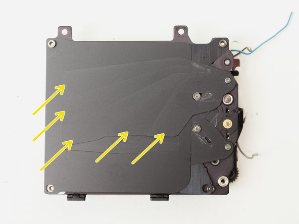

    7. Pentax ME Super Shutter Service, Remove closing curtain: crwdns2935265:026crwdnd2935265:01crwdnd2935265:03crwdne2935265:0 Pentax ME Super Shutter Service, Remove closing curtain: crwdns2935265:026crwdnd2935265:02crwdnd2935265:03crwdne2935265:0 Pentax ME Super Shutter Service, Remove closing curtain: crwdns2935265:026crwdnd2935265:03crwdnd2935265:03crwdne2935265:0
      • Unhook helper spring.
      • Remove closing curtain linkage.
      • Remove five individual curtain blades.

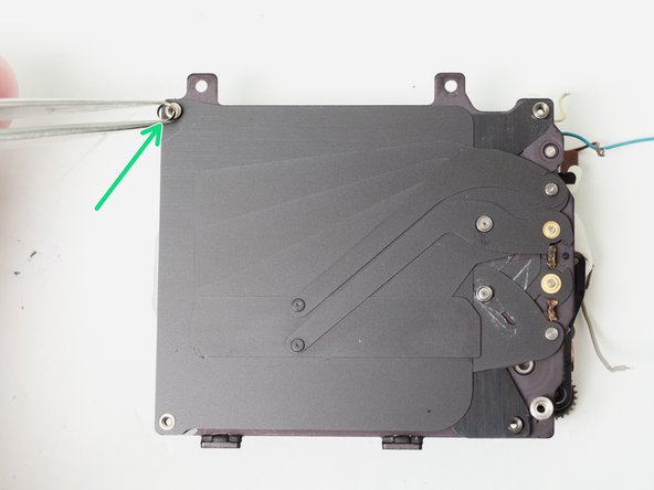

    8. Pentax ME Super Shutter Service, Remove curtain separator: crwdns2935265:027crwdnd2935265:01crwdnd2935265:02crwdne2935265:0 Pentax ME Super Shutter Service, Remove curtain separator: crwdns2935265:027crwdnd2935265:02crwdnd2935265:02crwdne2935265:0
      • Remove curtain separator.
      • Remove bottom spacer.

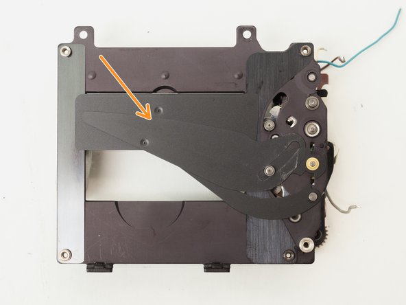

    9. Pentax ME Super Shutter Service, Remove opening curtain: crwdns2935265:028crwdnd2935265:01crwdnd2935265:03crwdne2935265:0 Pentax ME Super Shutter Service, Remove opening curtain: crwdns2935265:028crwdnd2935265:02crwdnd2935265:03crwdne2935265:0 Pentax ME Super Shutter Service, Remove opening curtain: crwdns2935265:028crwdnd2935265:03crwdnd2935265:03crwdne2935265:0
      • Remove three individual curtain blades.
      • Remove the opening curtain linkage.
      • Remove two curtain guides.
