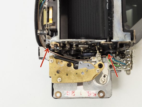

    8. Pentax ME Super Mirror Box Service, Remove mirror box screws: crwdns2935265:015crwdnd2935265:01crwdnd2935265:03crwdne2935265:0 Pentax ME Super Mirror Box Service, Remove mirror box screws: crwdns2935265:015crwdnd2935265:02crwdnd2935265:03crwdne2935265:0 Pentax ME Super Mirror Box Service, Remove mirror box screws: crwdns2935265:015crwdnd2935265:03crwdnd2935265:03crwdne2935265:0
      • Remove two 3.4 mm #00 screws.
      • Remove flex PCB retainer.
      • Remove shim washers. Note the location (left or right) and install in the same positions during reassembly.

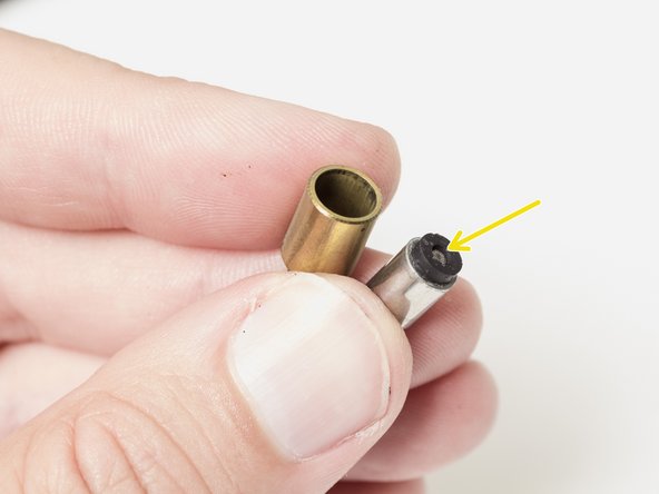

    4. Pentax ME Super Mirror Box Service, Problem areas: crwdns2935265:025crwdnd2935265:01crwdnd2935265:01crwdne2935265:0
      • The rubber bushing under this screw causes the most problems. As it degrades it prevents the lever from moving freely leading to stuck mirrors and other malfunctions.
      • Removing this lever and cleaning out the old bushing is usually enough to get the camera functioning again.
      • Complete disassembly and cleaning out additional degraded bushings is recommended for the long term health of the camera.

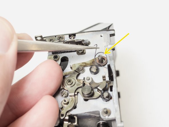

    9. Pentax ME Super Mirror Box Service, Remove mirror actuator lever: crwdns2935265:031crwdnd2935265:01crwdnd2935265:03crwdne2935265:0 Pentax ME Super Mirror Box Service, Remove mirror actuator lever: crwdns2935265:031crwdnd2935265:02crwdnd2935265:03crwdne2935265:0 Pentax ME Super Mirror Box Service, Remove mirror actuator lever: crwdns2935265:031crwdnd2935265:03crwdnd2935265:03crwdne2935265:0
      • Remove tension spring.
      • Remove one 4.0 mm #00 screw and washer.
      • Remove mirror actuator lever
      • White plastic bushing is loose and may fall off.
      • Remove shim washers if present.
