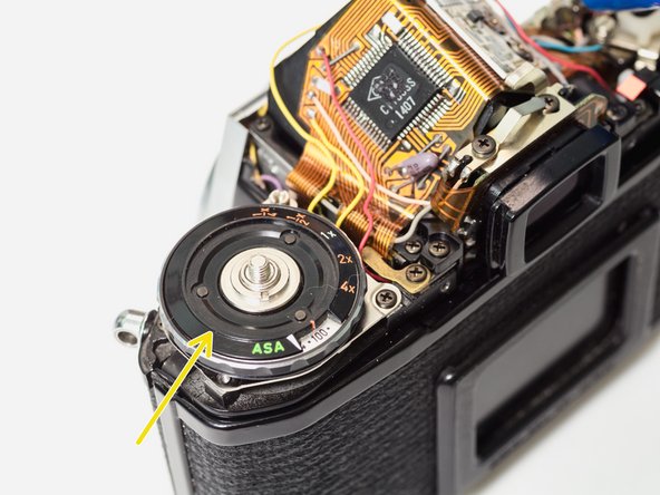

  3. Pentax ME Super Light Meter Adjustment, Installation Notes: ISO dial: crwdns2935265:03crwdnd2935265:01crwdnd2935265:01crwdne2935265:0
    • Ensure that the ISO dial couples with the tab on the resistor.
    • Turn the Exposure Compensation to 1/4x then back to 4x while gently pushing down. This will help the dial engage with the detent mechanism properly.

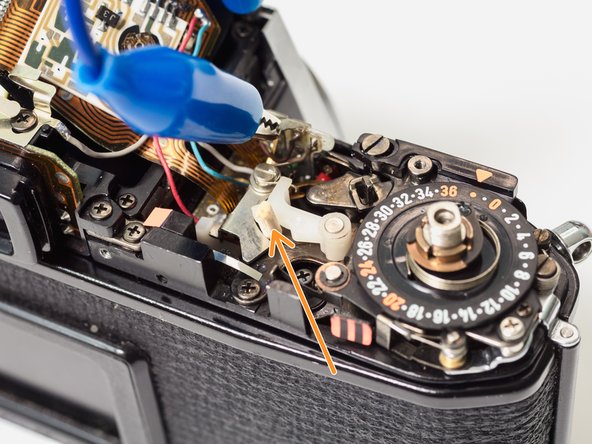

  8. Pentax ME Super Light Meter Adjustment, Put the camera in 'Auto' mode: crwdns2935265:08crwdnd2935265:01crwdnd2935265:03crwdne2935265:0 Pentax ME Super Light Meter Adjustment, Put the camera in 'Auto' mode: crwdns2935265:08crwdnd2935265:02crwdnd2935265:03crwdne2935265:0 Pentax ME Super Light Meter Adjustment, Put the camera in 'Auto' mode: crwdns2935265:08crwdnd2935265:03crwdnd2935265:03crwdne2935265:0
    • Ground the right most mode contact to the camera body. This puts the camera electronics in 'Auto' mode.
    • Insert a small rod between the mode levers. This puts the mechanics of the shutter in 'Auto' mode.

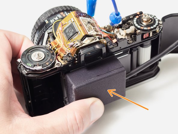

  9. Pentax ME Super Light Meter Adjustment, Prepare a scene: crwdns2935265:09crwdnd2935265:01crwdnd2935265:01crwdne2935265:0
    • Create a scene that fills the viewfinder with even brightness.

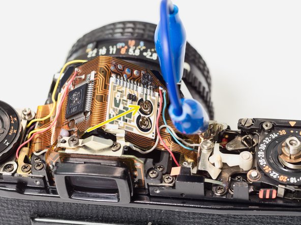

  10. Pentax ME Super Light Meter Adjustment, Match indicated speed to actual speed: crwdns2935265:010crwdnd2935265:01crwdnd2935265:03crwdne2935265:0 Pentax ME Super Light Meter Adjustment, Match indicated speed to actual speed: crwdns2935265:010crwdnd2935265:02crwdnd2935265:03crwdne2935265:0 Pentax ME Super Light Meter Adjustment, Match indicated speed to actual speed: crwdns2935265:010crwdnd2935265:03crwdnd2935265:03crwdne2935265:0
    • The ME Super has a stepless shutter in 'Auto' mode, which means it can fire at speeds inbetween the standard one stop increments. The indicated speed may be 1/60 but the metered speed could be anywhere from 1/45 to 1/90. The shutter will fire at the metered speed.
    • Use the 1/3rd stop increments of the ISO dial to determine if the indicated value is in the center or at the edge of the possible range. Adjust until it is centered.
    • Use a shutter speed tester to check the actual speed of the shutter and compare it to the indicated speed.
    • Adjust VR2 until the measured speed matches the indicated speed.
    • VR2 only affects the indicated speed in the viewfinder. It should not change the actual speed of the shutter.

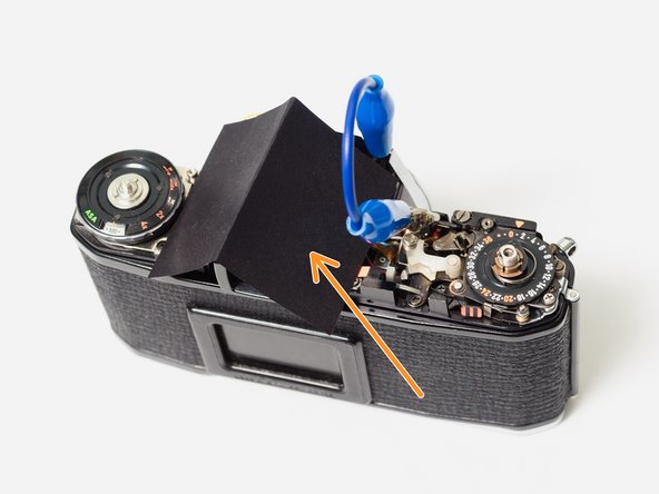

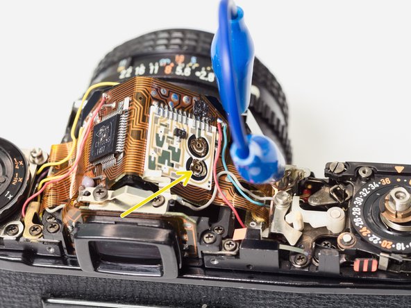

  11. Pentax ME Super Light Meter Adjustment, Adjust light meter exposure: crwdns2935265:011crwdnd2935265:01crwdnd2935265:03crwdne2935265:0 Pentax ME Super Light Meter Adjustment, Adjust light meter exposure: crwdns2935265:011crwdnd2935265:02crwdnd2935265:03crwdne2935265:0 Pentax ME Super Light Meter Adjustment, Adjust light meter exposure: crwdns2935265:011crwdnd2935265:03crwdnd2935265:03crwdne2935265:0
    • Mount a lens on the camera and measure the exposure for the scene with a known good light meter or camera.
    • Use a shroud to keep ambient light away from the light sensor. The light meter should only read light from the focusing screen of the camera.
    • Adjust VR1 until the metered exposure matches the correct exposure.
    • Repeat the last two steps at different exposure values for additional calibration points.
    • VR1 affects the speed of the shutter and the speed indicated in the viewfinder. They should change at the same rate.
