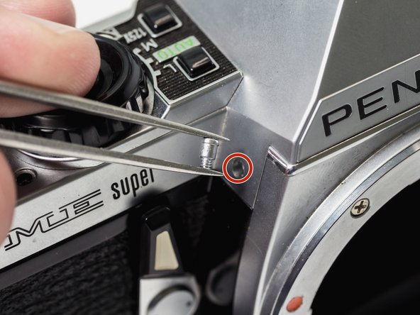

  4. Pentax ME Super Front Board and Mirror Box Removal, Unscrew top cover: crwdns2935265:04crwdnd2935265:01crwdnd2935265:03crwdne2935265:0 Pentax ME Super Front Board and Mirror Box Removal, Unscrew top cover: crwdns2935265:04crwdnd2935265:02crwdnd2935265:03crwdne2935265:0 Pentax ME Super Front Board and Mirror Box Removal, Unscrew top cover: crwdns2935265:04crwdnd2935265:03crwdnd2935265:03crwdne2935265:0
    • Remove two 3.3 mm #00 screws.
    • Remove one 3.2 mm #00 screw.
    • Remove one 2.6 mm #00 screw.
  5. Pentax ME Super Front Board and Mirror Box Removal, Unscrew top cover: crwdns2935265:05crwdnd2935265:01crwdnd2935265:02crwdne2935265:0 Pentax ME Super Front Board and Mirror Box Removal, Unscrew top cover: crwdns2935265:05crwdnd2935265:02crwdnd2935265:02crwdne2935265:0
    • Remove two 4.3 mm #00 screws.
