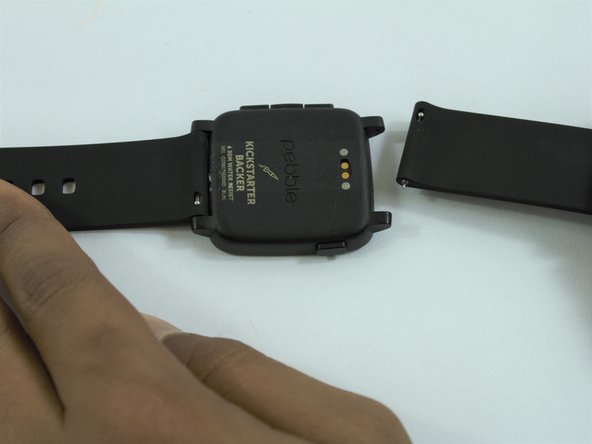

    • Locate the spring latch components on the back of the watch strap.
  2. Pebble Time Watch Strap Replacement: crwdns2935265:02crwdnd2935265:01crwdnd2935265:02crwdne2935265:0 Pebble Time Watch Strap Replacement: crwdns2935265:02crwdnd2935265:02crwdnd2935265:02crwdne2935265:0
    • Insert the metal spudger tool into the outer edge of the latch component.
    • Hold the watch securely and press the spring latch component towards you with the metal spudger tool.
  3. Pebble Time Watch Strap Replacement: crwdns2935265:03crwdnd2935265:01crwdnd2935265:02crwdne2935265:0 Pebble Time Watch Strap Replacement: crwdns2935265:03crwdnd2935265:02crwdnd2935265:02crwdne2935265:0
    • Remove the strap from the watch.
    • Repeat all steps on the opposite strap.
