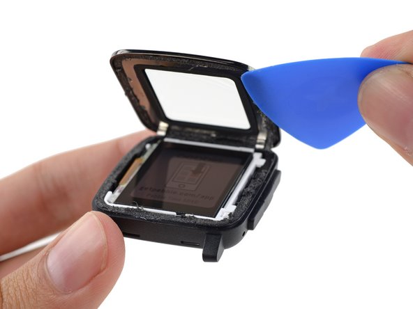

    • With a minimum amount of heat applied to the front bezel, we use an opening pick to pry along the perimeter of the Pebble Time.
    • Open, uh, sarsaparilla? Uh, open Saskatchewan? Open, septuagenarian? Uh, open, saddle soap? Open, sesame! And with that, the front bezel (includes the glass) surprisingly separates from the Pebble Time.
    • Time after time, we've seen displays fused to a device's front glass—a process that makes for thin displays that are nearly impossible to repair. Good news everyone! The color e-paper display is NOT fused to the front glass.
    • Now that we've sliced open the waterproof seal, this Pebble won't be splashing around any time soon—although some say that very small rocks float in water.

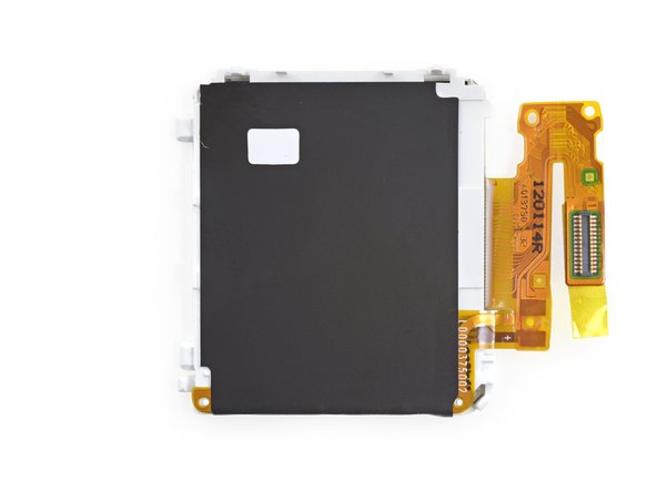

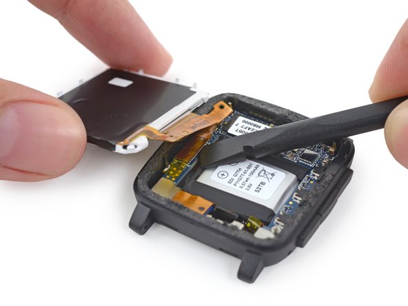

  6. Pebble Time Teardown: crwdns2935265:06crwdnd2935265:01crwdnd2935265:03crwdne2935265:0 Pebble Time Teardown: crwdns2935265:06crwdnd2935265:02crwdnd2935265:03crwdne2935265:0 Pebble Time Teardown: crwdns2935265:06crwdnd2935265:03crwdnd2935265:03crwdne2935265:0
    • We use a spudger to lift the display from its housing and are momentarily reminded of the cable wrangling that we had to perform in a recent teardown.
    • No time for origami here. We're happy to see that the display cable is only folded in half once. We quickly spudger the display connector from the motherboard and move on to the battery connector. Wait, where is the battery connector?

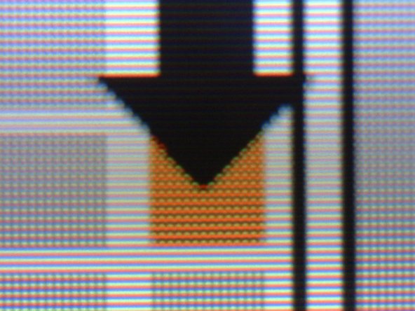

    • We go in for a closer look at the e-paper display, which in itself does a great job encapsulating the design choices and trade-offs of the Pebble Time.
    • With its comparatively limited color range (64 colors) and brightness, this display doesn't "pop" in the same way as some other smartwatch screens—but it has the distinct advantage of being always on, and of being fully visible in direct sunlight.
    • If you just want to know the time, it's there. No need to flick your wrist or squint at the display. However, there's also a manually-activated LED backlight, meaning there are still times when the display might be hard to read without a little brightness boost.
    • Pebble tells us this is a low-power, memory-in-pixel LCD. Through a microscope, we can see how the color trick is handled—different sized subpixels mix to create color.

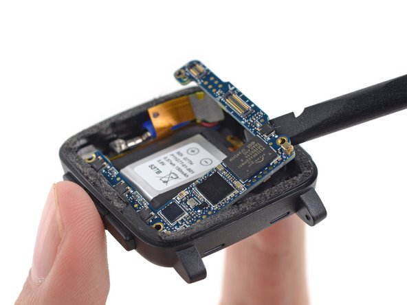

  8. Pebble Time Teardown: crwdns2935265:08crwdnd2935265:01crwdnd2935265:03crwdne2935265:0 Pebble Time Teardown: crwdns2935265:08crwdnd2935265:02crwdnd2935265:03crwdne2935265:0 Pebble Time Teardown: crwdns2935265:08crwdnd2935265:03crwdnd2935265:03crwdne2935265:0
    • To remove the motherboard, we need to disconnect a couple connectors and take out four Phillips #00 screws.
    • A quick flick of the spudger painlessly frees the U-shaped motherboard.
    • No adhesives or soldered-on cables here.
  9. Pebble Time Teardown: crwdns2935265:09crwdnd2935265:01crwdnd2935265:01crwdne2935265:0
    • We've chipped away at this Pebble—now let's have a look at the motherboard. Front-side ICs include:
    • ST Micro STM32F439ZG 180 MHz ARM Cortex-M4-based MCU
    • Spansion S29VS128R 128 Mb, 65 nm MirrorBit Flash
    • Texas Instruments CC2564B Bluetooth and Dual-Mode Controller
    • Ambient light sensor
  10. Pebble Time Teardown: crwdns2935265:010crwdnd2935265:01crwdnd2935265:01crwdne2935265:0
    • More ICs adorning the back side:
    • Lattice LP1K Field Programmable Gate Array
    • +14690B EWXS 9.504 AB Power Management IC; likely Maxim Integrated's MAX14690EWX
    • Linear Tech LT3009 Linear Regulator (Pebble tells us that the LT3009 is included for supplying power to the upcoming Smartstraps)
    • Bosch Sensortec BMI160 (6-axis IMU with acceleroemeter and gyroscope)
    • Freescale Xtrinsic MAG3110 3D Digital Magnetometer
    • Texas Instruments DRV2603 Motor Driver
    • The blue arrow points to the smartstrap data in/out pin; above it in red is the power in/out pin and below it is the smartstrap/charging ground pin. The red arrow points to the positive (+) battery connector and next to it in black is the negative (-) connector.

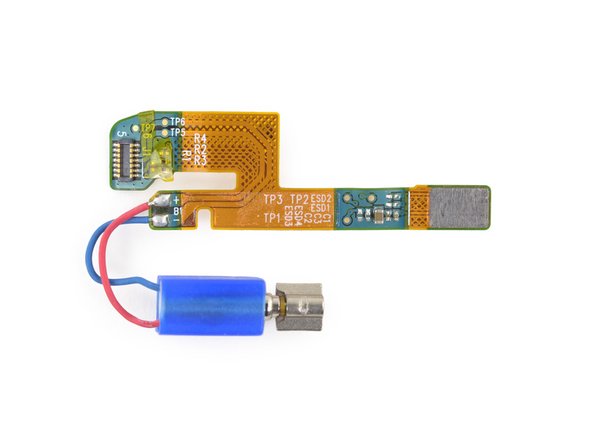

  12. Pebble Time Teardown: crwdns2935265:012crwdnd2935265:01crwdnd2935265:03crwdne2935265:0 Pebble Time Teardown: crwdns2935265:012crwdnd2935265:02crwdnd2935265:03crwdne2935265:0 Pebble Time Teardown: crwdns2935265:012crwdnd2935265:03crwdnd2935265:03crwdne2935265:0

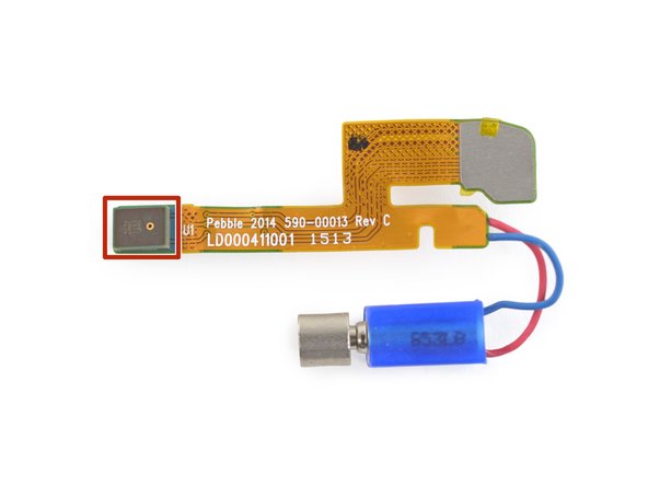

    • The microphone and vibrator assembly is next to be plucked out of (the) Time.
    • This is a Knowles microphone, waterproofed by a membrane behind the microphone port.
    • Since the Pebble is not compatible with Siri or Google Now, we asked Pebble what the microphone is going to be used for. They told us it's there for voice replies, and soon, voice notes. Neat!
    • We're all abuzz as we find the eccentric rotating mass vibrator soldered to the cable assembly, making replacement a tad bit more difficult.

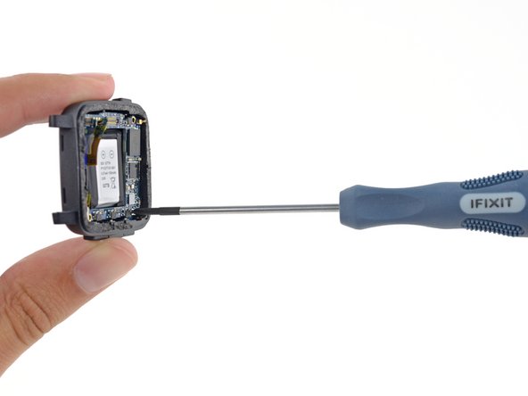

  13. Pebble Time Teardown: crwdns2935265:013crwdnd2935265:01crwdnd2935265:03crwdne2935265:0 Pebble Time Teardown: crwdns2935265:013crwdnd2935265:02crwdnd2935265:03crwdne2935265:0 Pebble Time Teardown: crwdns2935265:013crwdnd2935265:03crwdnd2935265:03crwdne2935265:0

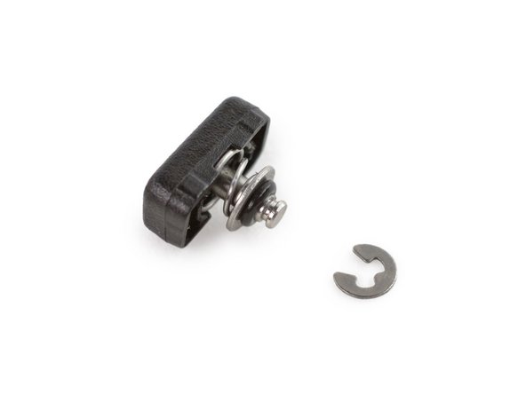

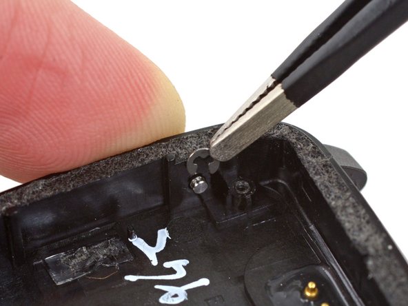

    • We're running out of things to pull from this Pebble's chassis. Those quality control markings prove difficult to grasp with our tweezers.
    • We asked and Pebble answered: these marks are confirmation that the rear case passed a water resistance inspection, which every rear case is subjected to before it gets to become a Time.
    • We manage to seize hold of this small c-clip securing the back button, which obligingly comes free for inspection.
    • The springy button is waterproofed by a small rubber o-ring.

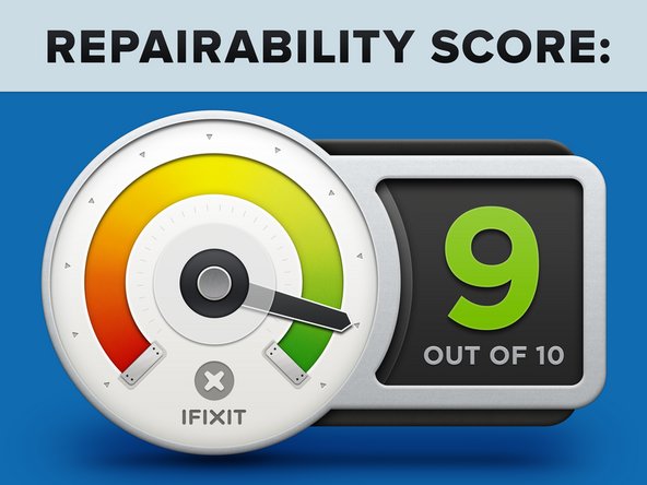

  14. Pebble Time Teardown: crwdns2935265:014crwdnd2935265:01crwdnd2935265:02crwdne2935265:0 Pebble Time Teardown: crwdns2935265:014crwdnd2935265:02crwdnd2935265:02crwdne2935265:0
    • Pebble Time Repairability Score: 9 out of 10
    • The watch band is an industry standard 22 mm band with a quick release mechanism, meaning replacement bands will be easy to source and install.
    • The Pebble Time uses standard Phillips #00 screws inside, and once you're inside, components are fairly modular and very easy to remove.
    • The front glass and e-paper display are not fused together—the two components can be replaced independently, lowering repair cost.
    • Although the battery is tucked away under the motherboard, it is modular and removable.
    • Removing the front glass requires heat and replacement adhesive.
