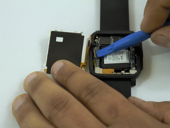

  7. Pebble Time Circuit Board Replacement: crwdns2935265:07crwdnd2935265:01crwdnd2935265:03crwdne2935265:0 Pebble Time Circuit Board Replacement: crwdns2935265:07crwdnd2935265:02crwdnd2935265:03crwdne2935265:0 Pebble Time Circuit Board Replacement: crwdns2935265:07crwdnd2935265:03crwdnd2935265:03crwdne2935265:0
    • Once screen is lifted, insert plastic opening tool between the screen connector and circuit board.
    • Disconnect the screen from the circuit board.

  10. Pebble Time Circuit Board Replacement: crwdns2935265:010crwdnd2935265:01crwdnd2935265:03crwdne2935265:0 Pebble Time Circuit Board Replacement: crwdns2935265:010crwdnd2935265:02crwdnd2935265:03crwdne2935265:0 Pebble Time Circuit Board Replacement: crwdns2935265:010crwdnd2935265:03crwdnd2935265:03crwdne2935265:0
    • Carefully disconnect the connector wire on the bottom left edge of the circuit board using a plastic opener tool.
    • Move apart the connector to expose the fourth screw.
