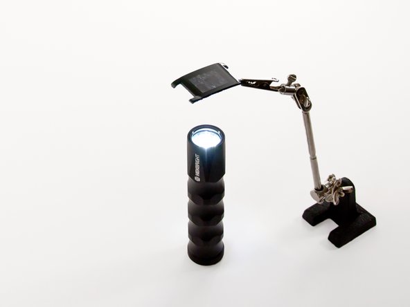

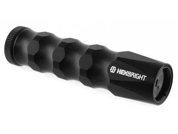

    • The screen may be busted, but it still makes a pretty rad display with the help of some HexBright backlighting.
    • It may seem like we just added this step to play with our HexBright (another Kickstarter project we're big fans of). If you thought this, you were correct.

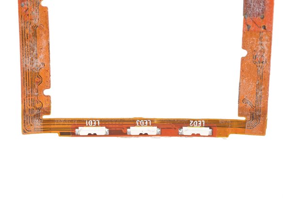

    • Peeling up the Pebble's e-paper display film reveals backlight LEDs. The small display only requires three LEDs (controllable by a wrist gesture) to light its face.

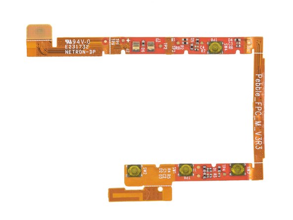

    • Removing the ribbon cable from the main assembly gives us a closer look at the buttons and Bluetooth antenna on one side, and the backlight LEDs on the reverse.
    • Since the cable houses all 4 buttons, 3 LEDs, and the Bluetooth 2.1 antenna, replacing an individual component will be impossible (even if you can somehow get inside without compromising the display).

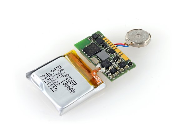

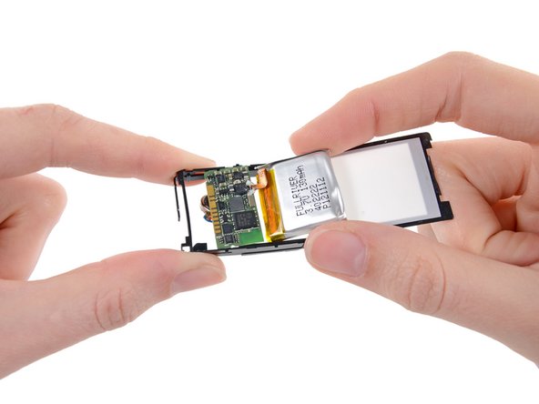

    • Removing the backlight guide panel from the device grants us access to the motherboard/battery/vibrator assembly.
    • Much like the ribbon cable, three components make up this assembly, held together by very delicate soldering. If any one of them fails (most significantly the battery), they will all need to be replaced as a single unit.

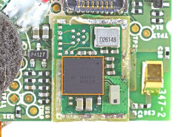

    • The back of the motherboard hosts a Panasonic pan1316 RF module, promising the Pebble's advertised Bluetooth and Bluetooth Low Energy (BLE) functionality, powered by a Texas Instruments CC2564 Bluetooth Controller.
    • After some dainty desoldering, the module's EMI shield is removed to surprisingly reveal a slightly different Texas Instruments CC2560A, that appears to not include BLE support.
    • The Bluetooth antenna printed into the flex circuit board connects to the pan1316 BT module here.
    • Word on the street was that Pebble had BLE functionality just waiting to be activated with a firmware update, but we can't find evidence of the hardware to back up this hidden potential.
    • Update: Pebble assures us that the update will be forthcoming, and explained that TI uses the same silicon for both the CC2560 and CC2564 parts—so despite the label on the chip, the update will make this a CC2564 with BLE support.

    • The Fullriver battery is rated at 3.7 Volts and 130 mAh. According to the GetPebble website, the battery is rechargeable via included USB charger, and lasts for over 7 days on a single charge.
    • This seems like a challenge to us, but with the use of e-paper, we believe that even heavy use would allow for such long battery life.

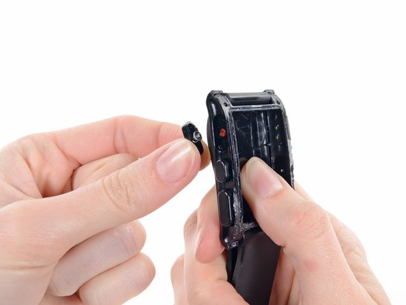

    • Just to be thorough, we go ahead and pop out a couple of the Pebble's spring-loaded buttons.
    • In keeping with the über tight waterproofing, the buttons have gaskets to allow for motion without leakage.
    • If you break one of the buttons, it can be replaced individually from the others; however, you still need to get into the watch in the first place, a feat we have not yet mastered.
