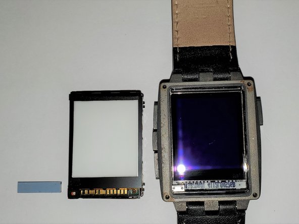

    • Use a pair of tweezers to grab the clip on each corner. Individually apply pressure inward while lifting to release each clip, but be careful not to damage the buttons ribbon cable. You should feel the internal frame release while doing this.
    • Lift the frame out of the pebble from the side with 3 buttons. (This will avoid damaging the internal charging contacts).

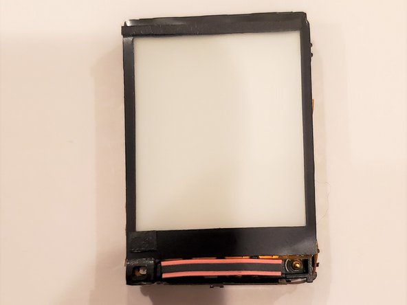

  4. Pebble Steel Zebra Strip Replacement: crwdns2935265:04crwdnd2935265:01crwdnd2935265:02crwdne2935265:0 Pebble Steel Zebra Strip Replacement: crwdns2935265:04crwdnd2935265:02crwdnd2935265:02crwdne2935265:0
    • The Zebra strip can stick to either the screen or the motherboard. Remove it with a pair of tweezers.

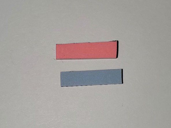

  5. Pebble Steel Zebra Strip Replacement: crwdns2935265:05crwdnd2935265:01crwdnd2935265:03crwdne2935265:0 Pebble Steel Zebra Strip Replacement: crwdns2935265:05crwdnd2935265:02crwdnd2935265:03crwdne2935265:0 Pebble Steel Zebra Strip Replacement: crwdns2935265:05crwdnd2935265:03crwdnd2935265:03crwdne2935265:0
    • The new zebra strip will be slightly "taller" than the existing one. This is intentional. Cutting it to be slightly "longer" than the original is fine as well. (The idea is to compress the new strip slightly.)
    • You can now re-insert the zebra strip from the motherboard side.
    • Insert the internal frame back into the Pebble's shell. (Zebra strip side/Backlight side down). At this point, you can screw the backplate onto the watch - try to preserve the oring/gasket integrity when doing so to ensure your Pebble remains water-tight.
