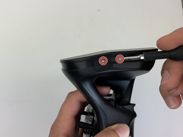

    • Remove the seven silver 4mm screws from around the edge of the top panel using the Torx TR6 screwdriver.
    • The opposite side to the third picture has a screw located on each side of the USB port.
