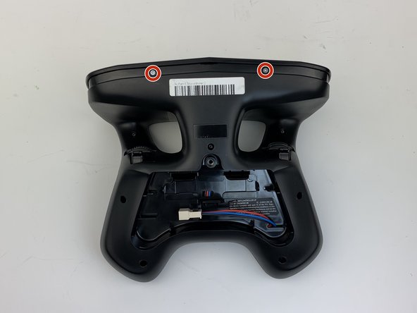

      • Flip your controller face down.
    2. Parrot Skycontroller 2 Buttons Replacement: crwdns2935265:02crwdnd2935265:01crwdnd2935265:01crwdne2935265:0
      • Remove one 9mm screw using a #4 flathead screwdriver.
    3. Parrot Skycontroller 2 Buttons Replacement: crwdns2935265:03crwdnd2935265:01crwdnd2935265:03crwdne2935265:0 Parrot Skycontroller 2 Buttons Replacement: crwdns2935265:03crwdnd2935265:02crwdnd2935265:03crwdne2935265:0 Parrot Skycontroller 2 Buttons Replacement: crwdns2935265:03crwdnd2935265:03crwdnd2935265:03crwdne2935265:0
      • Insert the plastic opening tool into the top of the cover and pry upwards to lift the battery cover.
      • Remove the cover by pulling up and out.

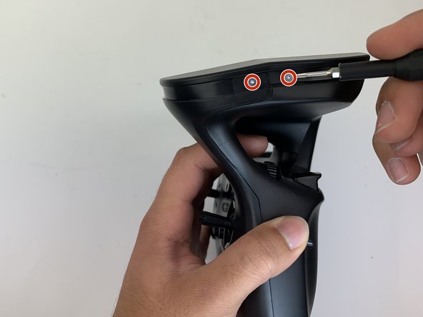

    1. Parrot Skycontroller 2 Buttons Replacement, Buttons: crwdns2935265:06crwdnd2935265:01crwdnd2935265:01crwdne2935265:0
      • Remove the seven black 11mm screws using the Torx TR6 screwdriver.
      • There is a hidden screw located behind the sticker in the battery compartment.
      • Pull back the sticker with your finger nail and remove the one black 11mm screw using the Torx TR6 screwdriver.

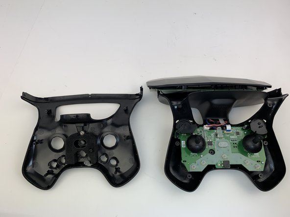

    5. Parrot Skycontroller 2 Buttons Replacement: crwdns2935265:010crwdnd2935265:01crwdnd2935265:02crwdne2935265:0 Parrot Skycontroller 2 Buttons Replacement: crwdns2935265:010crwdnd2935265:02crwdnd2935265:02crwdne2935265:0
      • Remove the face plate by pulling up and out.
      • Buttons will fall out when this plate is removed.

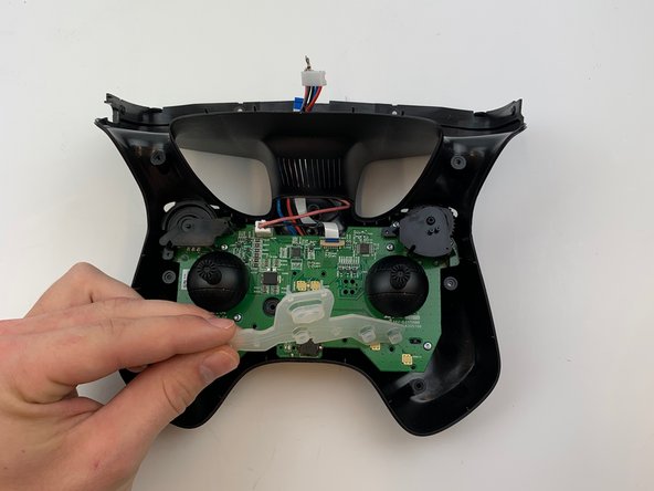

    6. Parrot Skycontroller 2 Buttons Replacement: crwdns2935265:011crwdnd2935265:01crwdnd2935265:03crwdne2935265:0 Parrot Skycontroller 2 Buttons Replacement: crwdns2935265:011crwdnd2935265:02crwdnd2935265:03crwdne2935265:0 Parrot Skycontroller 2 Buttons Replacement: crwdns2935265:011crwdnd2935265:03crwdnd2935265:03crwdne2935265:0
      • Use some force pull up and out on the rubber backing for the buttons.
