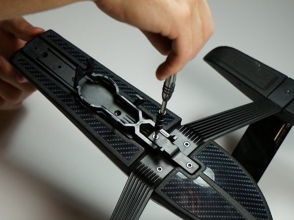

    • Place the boat so that the front faces to the right.
  2. Parrot Hydrofoil Orak Lever Arm Replacement: crwdns2935265:02crwdnd2935265:01crwdnd2935265:02crwdne2935265:0 Parrot Hydrofoil Orak Lever Arm Replacement: crwdns2935265:02crwdnd2935265:02crwdnd2935265:02crwdne2935265:0
    • Remove the far left 1cm screw using a T8 screwdriver.
  3. Parrot Hydrofoil Orak Lever Arm Replacement: crwdns2935265:03crwdnd2935265:01crwdnd2935265:01crwdne2935265:0
    • Remove the rudder.

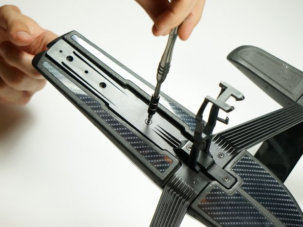

  4. Parrot Hydrofoil Orak Lever Arm Replacement, Lever Arm: crwdns2935265:04crwdnd2935265:01crwdnd2935265:03crwdne2935265:0 Parrot Hydrofoil Orak Lever Arm Replacement, Lever Arm: crwdns2935265:04crwdnd2935265:02crwdnd2935265:03crwdne2935265:0 Parrot Hydrofoil Orak Lever Arm Replacement, Lever Arm: crwdns2935265:04crwdnd2935265:03crwdnd2935265:03crwdne2935265:0
    • Remove the four remaining 1cm screws with the T8 screw driver.
  5. Parrot Hydrofoil Orak Lever Arm Replacement: crwdns2935265:05crwdnd2935265:01crwdnd2935265:01crwdne2935265:0
    • Lift up on the plastic piece that is securing the lever arm.

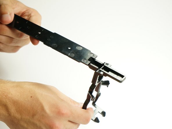

    • Flip the plastic part upside down to reveal where the lever arm sits.
  7. Parrot Hydrofoil Orak Lever Arm Replacement: crwdns2935265:07crwdnd2935265:01crwdnd2935265:03crwdne2935265:0 Parrot Hydrofoil Orak Lever Arm Replacement: crwdns2935265:07crwdnd2935265:02crwdnd2935265:03crwdne2935265:0 Parrot Hydrofoil Orak Lever Arm Replacement: crwdns2935265:07crwdnd2935265:03crwdnd2935265:03crwdne2935265:0
    • Lift the lever arm from the slot it is in and slide off of the end of the plastic piece that was holding it to the boat.
