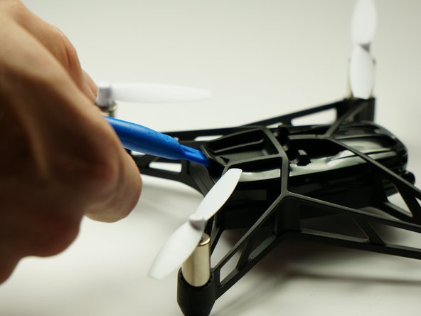

    • Orient the device so that the front of the boat chasis is facing to your right.
  2. Parrot Hydrofoil Orak Battery Replacement: crwdns2935265:02crwdnd2935265:01crwdnd2935265:03crwdne2935265:0 Parrot Hydrofoil Orak Battery Replacement: crwdns2935265:02crwdnd2935265:02crwdnd2935265:03crwdne2935265:0 Parrot Hydrofoil Orak Battery Replacement: crwdns2935265:02crwdnd2935265:03crwdnd2935265:03crwdne2935265:0
    • Use your pointer finger on one tab, your middle finger on the other, and your thumb on the bottom to pry the tabs away and lift the drone out of the holder.
  3. Parrot Hydrofoil Orak Battery Replacement: crwdns2935265:03crwdnd2935265:01crwdnd2935265:02crwdne2935265:0 Parrot Hydrofoil Orak Battery Replacement: crwdns2935265:03crwdnd2935265:02crwdnd2935265:02crwdne2935265:0
    • Insert your plastic opening tool in between the tab with the arrow on it and the battery below it.
    • Pry the tool upwards to disengage the battery.
    • You can disengage the battery with your finger rather than an opening tool, although it takes quite a bit of force and you may need strong nails.
  4. Parrot Hydrofoil Orak Battery Replacement: crwdns2935265:04crwdnd2935265:01crwdnd2935265:01crwdne2935265:0
    • Pull the battery fully out using your fingers.
