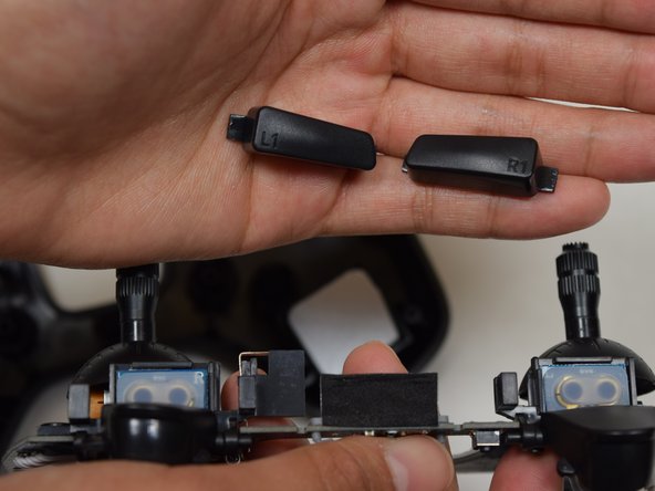

    • Remove the foam adhesive that connects the front plate to the motherboard
    • The buttons (L1,R1) may fall out. Set aside to replace during reassembly.
    • Use a Phillips #0 screwdriver to remove the two 0.7 mm screws.
    • Remove the motherboard from the front plate.

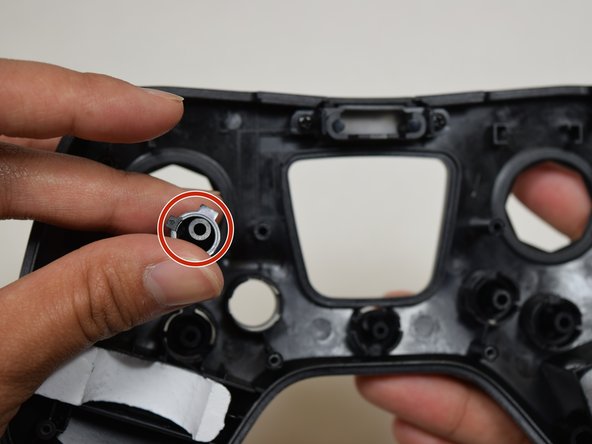

  3. Parrot FLYPAD Buttons Replacement: crwdns2935265:03crwdnd2935265:01crwdnd2935265:03crwdne2935265:0 Parrot FLYPAD Buttons Replacement: crwdns2935265:03crwdnd2935265:02crwdnd2935265:03crwdne2935265:0 Parrot FLYPAD Buttons Replacement: crwdns2935265:03crwdnd2935265:03crwdnd2935265:03crwdne2935265:0
    • Remove the buttons from the front plate of the fly pad and replace as needed.
    • Hold the front plate of the fly pad facing downwards to prevent buttons from falling out.
    • Make sure the text on buttons L1 and R1 correctly line up with L2 and R2 when reassembling the device.
