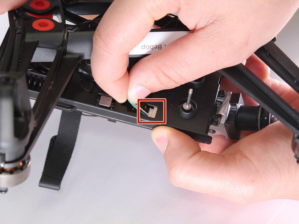

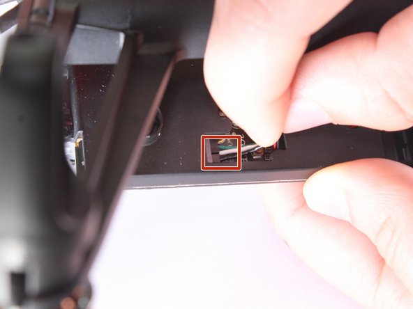

    • Using both hands gently pull the two pieces of the frame apart until you can see the connectors under the frame attached to the motherboard.
    • Remove both of the connectors from the motherboard. There is one connector on each side.
    • Do not fully remove the frame until both of the connectors are detached from the motherboard.

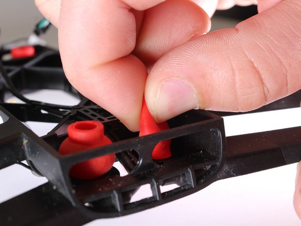

    • Remove the four rubber shock absorbers by squeezing and twisting them while also pulling up.
    • Insert replacement rubber shock absorbers by placing one side in the hole and pushing down. Verify the shock absorbers are seated with a gentle tug.
