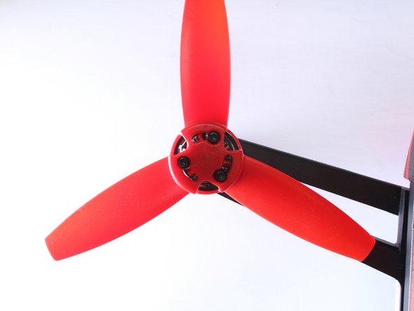

    • Using the propeller removal tool (included with the Parrot Bebop Drone), line up the holes with the protruding screws.
  2. Parrot Bebop Drone Propeller Replacement: crwdns2935265:02crwdnd2935265:01crwdnd2935265:02crwdne2935265:0 Parrot Bebop Drone Propeller Replacement: crwdns2935265:02crwdnd2935265:02crwdnd2935265:02crwdne2935265:0
    • While holding the propeller in place, rotate the tool counterclockwise until the screws are aligned with the holes on the propeller.
  3. Parrot Bebop Drone Propeller Replacement: crwdns2935265:03crwdnd2935265:01crwdnd2935265:01crwdne2935265:0
    • While gently pushing down on the arm of which the propeller is attached, pull the propeller up off the motor.

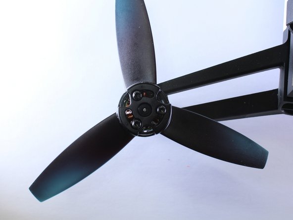

  4. Parrot Bebop Drone Propeller Replacement: crwdns2935265:04crwdnd2935265:01crwdnd2935265:03crwdne2935265:0 Parrot Bebop Drone Propeller Replacement: crwdns2935265:04crwdnd2935265:02crwdnd2935265:03crwdne2935265:0 Parrot Bebop Drone Propeller Replacement: crwdns2935265:04crwdnd2935265:03crwdnd2935265:03crwdne2935265:0
    • When putting the propellers back on, the red propellers go up front and the black ones go on the back.
    • The motors with the protruding axles (front right and rear left) have the propeller with the hole in the middle while the motors without the protruding axles (front left and rear right) have the propellers without the hole in the middle.
