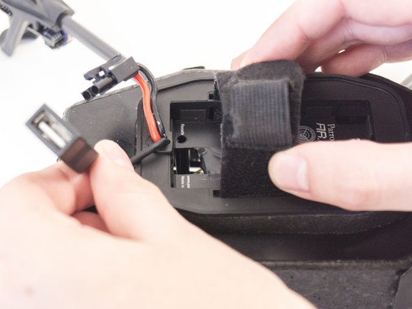

    • Turn the drone right side up
    • Remove the USB connector from the battery retaining straps.
  9. Parrot AR.Drone 2.0 Central Cross Replacement: crwdns2935265:09crwdnd2935265:01crwdnd2935265:01crwdne2935265:0
    • Release the rubber clip holding the USB and battery power cable to the body.
  10. Parrot AR.Drone 2.0 Central Cross Replacement: crwdns2935265:010crwdnd2935265:01crwdnd2935265:02crwdne2935265:0 Parrot AR.Drone 2.0 Central Cross Replacement: crwdns2935265:010crwdnd2935265:02crwdnd2935265:02crwdne2935265:0
    • Avoid using sharp tools near the battery.
    • Push the USB and power cable through the battery panel.
