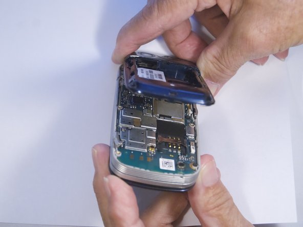

  8. Pantech Matrix Motherboard Replacement, Remove Phone Casing: crwdns2935265:08crwdnd2935265:01crwdnd2935265:02crwdne2935265:0 Pantech Matrix Motherboard Replacement, Remove Phone Casing: crwdns2935265:08crwdnd2935265:02crwdnd2935265:02crwdne2935265:0
    • Rotate the phone so the base is facing you.
    • Use spudger to separate phone casing and inside as shown.
    • Remove the casing carefully and set aside.
