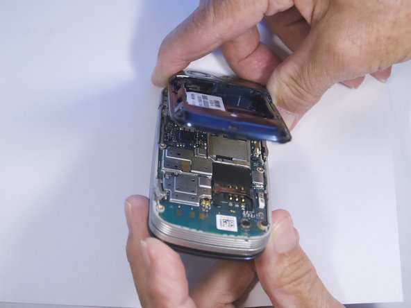

    2. Pantech Matrix Camera Button Replacement, Identify and Remove Phone Casing: crwdns2935265:08crwdnd2935265:01crwdnd2935265:02crwdne2935265:0 Pantech Matrix Camera Button Replacement, Identify and Remove Phone Casing: crwdns2935265:08crwdnd2935265:02crwdnd2935265:02crwdne2935265:0
      • Rotate the phone so the base is facing you.
      • Use spudger to separate phone casing and inside as shown.
      • Remove the casing carefully and set aside.

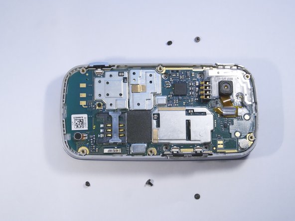

    3. Pantech Matrix Camera Button Replacement, Remove Camera Screws: crwdns2935265:09crwdnd2935265:01crwdnd2935265:02crwdne2935265:0 Pantech Matrix Camera Button Replacement, Remove Camera Screws: crwdns2935265:09crwdnd2935265:02crwdnd2935265:02crwdne2935265:0
      • Place phone with exposed motherboard facing you.
      • Use a Phillips screwdriver to remove the five 2mm Phillips #000 screws holding the camera in place.
    4. Pantech Matrix Camera Button Replacement, Identify and Remove Camera Button: crwdns2935265:010crwdnd2935265:01crwdnd2935265:02crwdne2935265:0 Pantech Matrix Camera Button Replacement, Identify and Remove Camera Button: crwdns2935265:010crwdnd2935265:02crwdnd2935265:02crwdne2935265:0
      • Carefully remove the motherboard to expose the camera button.
      • Grasp the camera button with a polypus and pull gently to remove the camera button.
