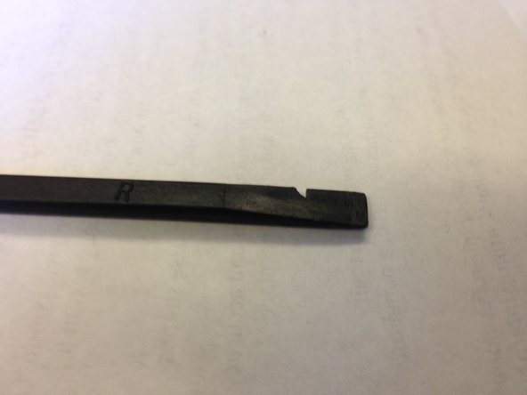

    3. Pantech CDM8975 Screen Replacement: crwdns2935265:03crwdnd2935265:01crwdnd2935265:02crwdne2935265:0 Pantech CDM8975 Screen Replacement: crwdns2935265:03crwdnd2935265:02crwdnd2935265:02crwdne2935265:0
      • Use a spudger to separate the back shield from the top half of the phone.
      • Warning: Remove the battery prior to removing the screen.

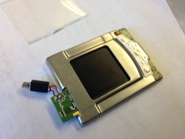

    6. Pantech CDM8975 Screen Replacement: crwdns2935265:06crwdnd2935265:01crwdnd2935265:01crwdne2935265:0
      • The original LCD screen will have components (like a microphone, speakers, etc.) attached by wires. If your replacement LCD screen is similar, then take out the original LCD screen (with attachments) and replace it with the new LCD screen. You can skip steps 8-11, since they do not apply to this situation.
      • Note: If your replacement LCD screen did not come with components (like microphone, speakers, etc.) attached, then continue with the guide as written.
      • Using wire cutters, disconnect the speaker from the phone.
      • Your phone will look different from these pictures, since the cutting steps have not been performed. Follow the steps in the guide for true instructions - pictures are only to help illustrate locations of steps.

    8. Pantech CDM8975 Screen Replacement: crwdns2935265:08crwdnd2935265:01crwdnd2935265:02crwdne2935265:0 Pantech CDM8975 Screen Replacement: crwdns2935265:08crwdnd2935265:02crwdnd2935265:02crwdne2935265:0
      • Carefully remove the screen. Leave the wires from the speakers exposed (top of the phone).
