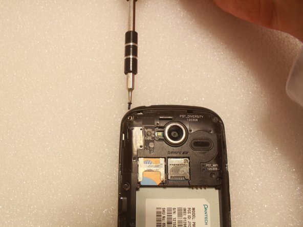

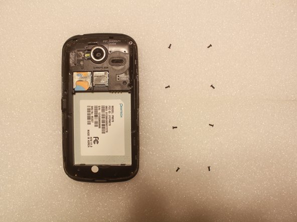

  3. Pantech Burst Motherboard Replacement: crwdns2935265:03crwdnd2935265:01crwdnd2935265:03crwdne2935265:0 Pantech Burst Motherboard Replacement: crwdns2935265:03crwdnd2935265:02crwdnd2935265:03crwdne2935265:0 Pantech Burst Motherboard Replacement: crwdns2935265:03crwdnd2935265:03crwdnd2935265:03crwdne2935265:0
    • Undo all 8 visible screws using a phillips size 000 screwdriver.
    • The screws are marked in red on the picture.

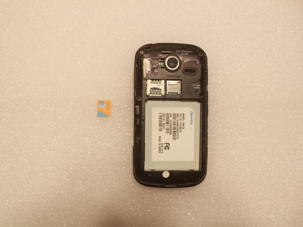

  4. Pantech Burst Motherboard Replacement: crwdns2935265:04crwdnd2935265:01crwdnd2935265:02crwdne2935265:0 Pantech Burst Motherboard Replacement: crwdns2935265:04crwdnd2935265:02crwdnd2935265:02crwdne2935265:0
    • Remove the SD card if there is one inserted into the phone.

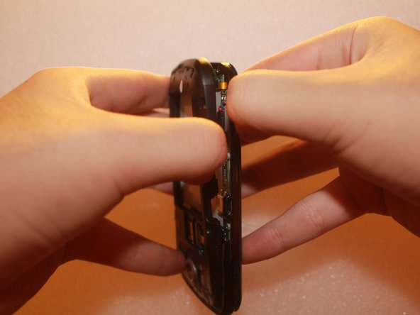

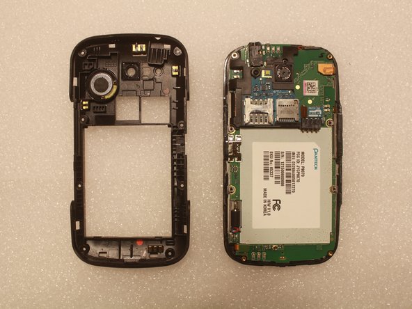

  5. Pantech Burst Motherboard Replacement: crwdns2935265:05crwdnd2935265:01crwdnd2935265:03crwdne2935265:0 Pantech Burst Motherboard Replacement: crwdns2935265:05crwdnd2935265:02crwdnd2935265:03crwdne2935265:0 Pantech Burst Motherboard Replacement: crwdns2935265:05crwdnd2935265:03crwdnd2935265:03crwdne2935265:0
    • Using an opening tool or some other solid, flat-ended tool, begin pulling apart the phone from the indent below the USB port.
    • Continue using the tool, while moving around the edge of the phone until the two parts are largely disengaged.
    • Once there is space enough to pull the pieces apart with your fingers, you may do so.
    • Opening the phone may require a good amount of force.

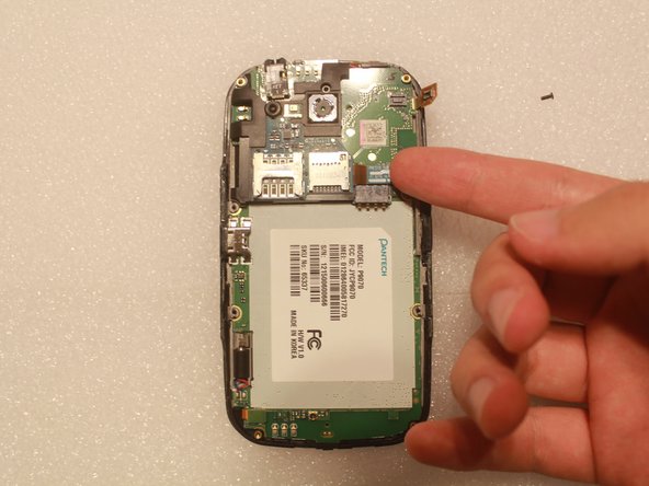

  7. Pantech Burst Motherboard Replacement: crwdns2935265:07crwdnd2935265:01crwdnd2935265:01crwdne2935265:0
    • Gently disconnect the connectors attached to the motherboard using a fingernail to pull them up from the board.
    • Connectors are marked in blue in the image.

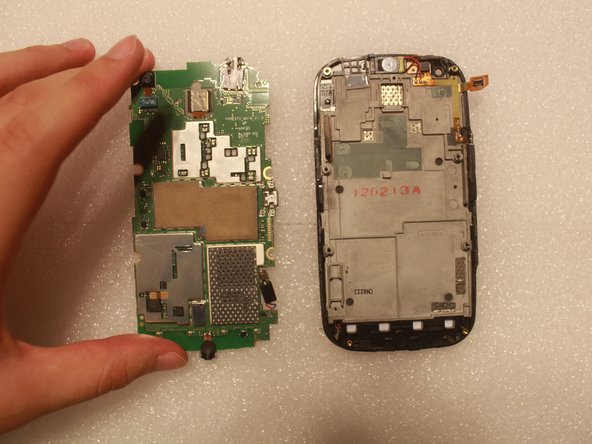

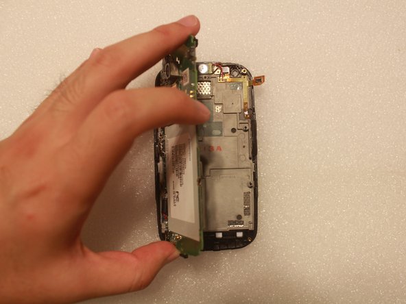

  8. Pantech Burst Motherboard Replacement: crwdns2935265:08crwdnd2935265:01crwdnd2935265:03crwdne2935265:0 Pantech Burst Motherboard Replacement: crwdns2935265:08crwdnd2935265:02crwdnd2935265:03crwdne2935265:0 Pantech Burst Motherboard Replacement: crwdns2935265:08crwdnd2935265:03crwdnd2935265:03crwdne2935265:0
    • Starting from the bottom and going around counterclockwise, carefully pry the motherboard out of the device.
    • Beginning with the side with the USB port may damage the phone.
