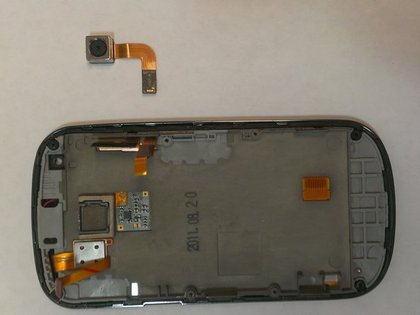

  8. Pantech Breakout Rear Facing Camera Replacement, Removing Rear Facing Camera: crwdns2935265:08crwdnd2935265:01crwdnd2935265:02crwdne2935265:0 Pantech Breakout Rear Facing Camera Replacement, Removing Rear Facing Camera: crwdns2935265:08crwdnd2935265:02crwdnd2935265:02crwdne2935265:0
    • The rear facing camera is attached to the back of the screen with adhesive.
    • To remove, apply constant pressure with a prying tool at the base of the camera.
When re-installing a rear facing camera, it might be necessary to add a small amount of adhesive to the base of the camera to keep it in place. Also, the cable ribbon of the rear facing camera should lead out of the bottom of the camera.
