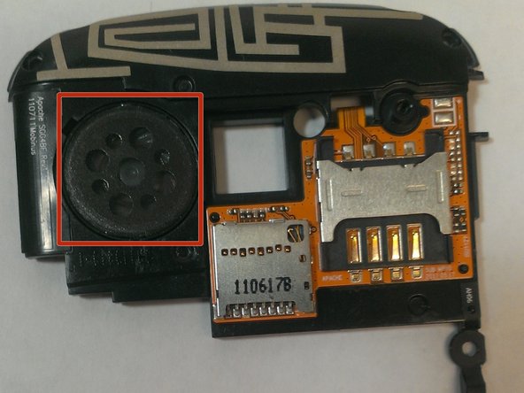

    • After removal of front bezel and back cover, locate and remove two Phillips #000 screws from the top corners of the phone.
    • After taking out the screws, lift off the black plastic piece containing the speaker, Micro SD card slot and SIM card slot.

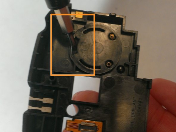

  7. Pantech Breakout Loud Speaker Replacement, Replacing Speaker: crwdns2935265:07crwdnd2935265:01crwdnd2935265:03crwdne2935265:0 Pantech Breakout Loud Speaker Replacement, Replacing Speaker: crwdns2935265:07crwdnd2935265:02crwdnd2935265:03crwdne2935265:0 Pantech Breakout Loud Speaker Replacement, Replacing Speaker: crwdns2935265:07crwdnd2935265:03crwdnd2935265:03crwdne2935265:0
    • The black plastic piece that was just removed contains the speaker, the Micro SD card slot, and the SIM card slot.
    • Gently push against the back of the speaker with a very small screw driver or other slim tool. The speaker will pop out and can be switched with a working unit.
