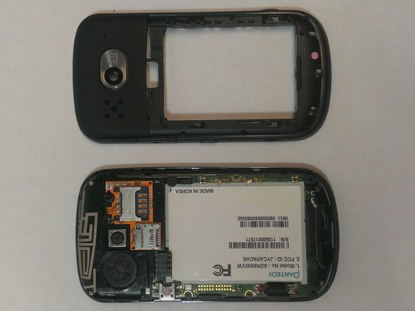

  5. Pantech Breakout Front Facing Camera Replacement, Removing Back Case: crwdns2935265:05crwdnd2935265:01crwdnd2935265:02crwdne2935265:0 Pantech Breakout Front Facing Camera Replacement, Removing Back Case: crwdns2935265:05crwdnd2935265:02crwdnd2935265:02crwdne2935265:0
    • Starting at the charging port cover open by prying away from front face to remove back case.
    • Make sure that no part of the back case is caught on any other part of the phone; the USB charging port can get in the way.

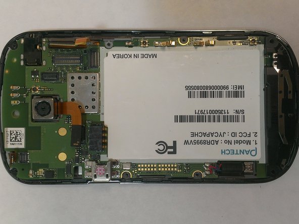

    • After removing the bevel and back case of the phone, you will now see the motherboard and other internal components.

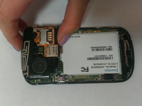

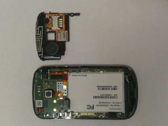

    • After removal of front bezel and back cover, locate and remove two Phillips #000 screws from the top corners of the phone.
    • After taking out the screws, lift off the black plastic piece containing the speaker, Micro SD card slot and SIM card slot.

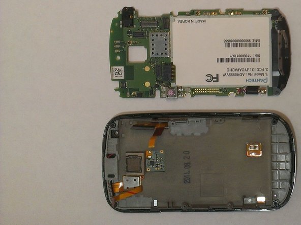

  7. Pantech Breakout Front Facing Camera Replacement, Disconnecting Ribbon Cables: crwdns2935265:07crwdnd2935265:01crwdnd2935265:03crwdne2935265:0 Pantech Breakout Front Facing Camera Replacement, Disconnecting Ribbon Cables: crwdns2935265:07crwdnd2935265:02crwdnd2935265:03crwdne2935265:0 Pantech Breakout Front Facing Camera Replacement, Disconnecting Ribbon Cables: crwdns2935265:07crwdnd2935265:03crwdnd2935265:03crwdne2935265:0
    • Locate the four ribbon connections near the top of the phone, above where the battery was.
    • Using a set of Tweezers, carefully pull each ribbon up from its connection. After this is complete, the motherboard will freely separate from the back of the screen.
    • Separate motherboard from screen.
    • The vibrator motor will be dangling from the motherboard by a wire, it is not detachable.

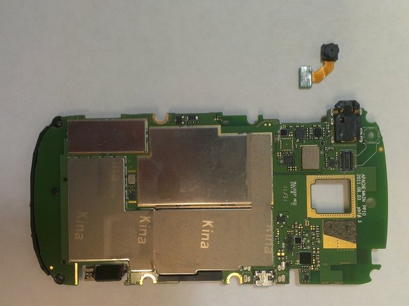

  8. Pantech Breakout Front Facing Camera Replacement, Remove Front Facing Camera: crwdns2935265:08crwdnd2935265:01crwdnd2935265:02crwdne2935265:0 Pantech Breakout Front Facing Camera Replacement, Remove Front Facing Camera: crwdns2935265:08crwdnd2935265:02crwdnd2935265:02crwdne2935265:0
    • The front facing camera is attached to the back of the motherboard by a single cable ribbon.
    • Flip the motherboard over to the back, this is where the front facing camera is located.
    • To remove, use a set of Tweezers to carefully pull the cable ribbon up from its connection.
When re-installing a front facing camera, carefully place the cable ribbon into its connection. Also, the cable ribbon of the front facing camera should come out the right side of the camera.
