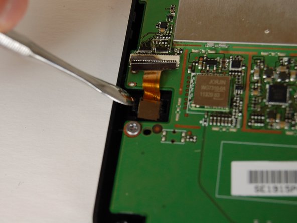

  6. Pandigital Super Nova Front Facing Camera Replacement, Front Facing Camera: crwdns2935265:06crwdnd2935265:01crwdnd2935265:02crwdne2935265:0 Pandigital Super Nova Front Facing Camera Replacement, Front Facing Camera: crwdns2935265:06crwdnd2935265:02crwdnd2935265:02crwdne2935265:0
    • Use a metal pry tool to separate the camera and the small clip that holds it in place.
    • Do NOT touch the MotherBoard with your bare hands. There is risk of short circuiting the device. Use nitrile gloves to prevent this.
  7. Pandigital Super Nova Front Facing Camera Replacement: crwdns2935265:07crwdnd2935265:01crwdnd2935265:02crwdne2935265:0 Pandigital Super Nova Front Facing Camera Replacement: crwdns2935265:07crwdnd2935265:02crwdnd2935265:02crwdne2935265:0
    • Use a pair of small tweezers to gently pull the camera connector out of the motherboard.
