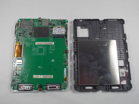

    • Using a Phillips #0 bit, remove the 12 4mm screws.
  4. Pandigital Novel PRD07T10WWH7 Wireless Card Replacement: crwdns2935265:04crwdnd2935265:01crwdnd2935265:03crwdne2935265:0 Pandigital Novel PRD07T10WWH7 Wireless Card Replacement: crwdns2935265:04crwdnd2935265:02crwdnd2935265:03crwdne2935265:0 Pandigital Novel PRD07T10WWH7 Wireless Card Replacement: crwdns2935265:04crwdnd2935265:03crwdnd2935265:03crwdne2935265:0

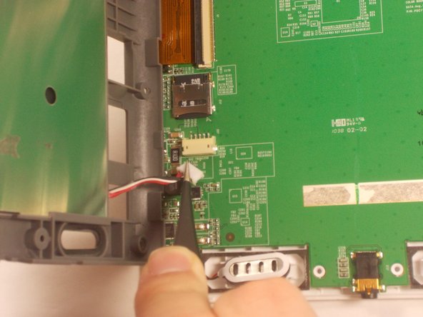

    • Pry off the gray piece by removing the clips around it.
    • Then, unplug the battery and separate the gray piece from the motherboard

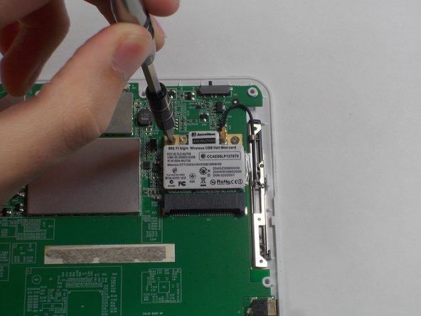

    • Using a Phillips #0 bit, remove the two 3mm screws at the top of the wireless card.
  6. Pandigital Novel PRD07T10WWH7 Wireless Card Replacement: crwdns2935265:06crwdnd2935265:01crwdnd2935265:02crwdne2935265:0 Pandigital Novel PRD07T10WWH7 Wireless Card Replacement: crwdns2935265:06crwdnd2935265:02crwdnd2935265:02crwdne2935265:0

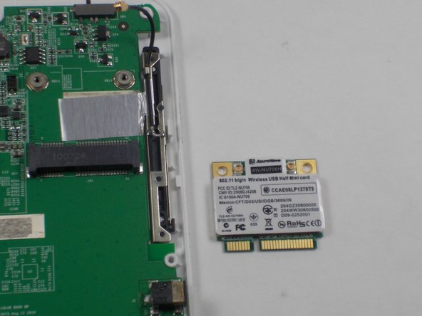

    • Unplug the wire from the wireless card.
    • Flip up the retaining flap, releasing the card.
