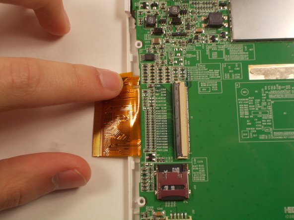

  6. Pandigital Novel PRD07T10WWH7 Speaker Replacement: crwdns2935265:06crwdnd2935265:01crwdnd2935265:02crwdne2935265:0 Pandigital Novel PRD07T10WWH7 Speaker Replacement: crwdns2935265:06crwdnd2935265:02crwdnd2935265:02crwdne2935265:0
    • Use the tip of your plastic spudger or your fingernail to flip up the long retaining flap. The longer, gold ribbon cable can now be pulled out safely.

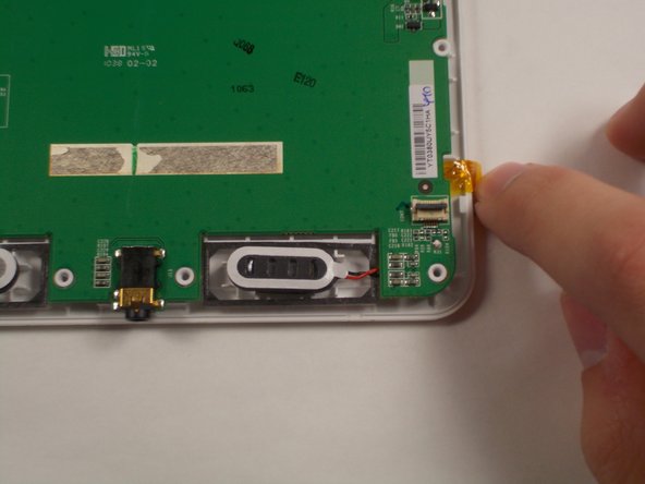

  7. Pandigital Novel PRD07T10WWH7 Speaker Replacement: crwdns2935265:07crwdnd2935265:01crwdnd2935265:02crwdne2935265:0 Pandigital Novel PRD07T10WWH7 Speaker Replacement: crwdns2935265:07crwdnd2935265:02crwdnd2935265:02crwdne2935265:0
    • Use the tip of your plastic spudger or your fingernail to flip up the shorter retaining flap. The smaller gold ribbon cable can now be pulled out safely.

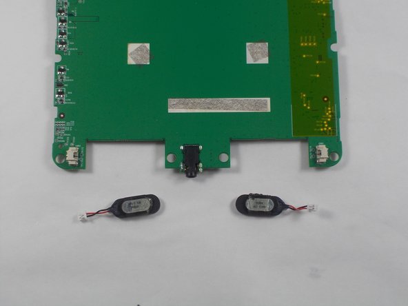

  8. Pandigital Novel PRD07T10WWH7 Speaker Replacement: crwdns2935265:08crwdnd2935265:01crwdnd2935265:01crwdne2935265:0
    • Starting from the side of the device, lift the motherboard off of the plastic standoffs.
    • You will need to peel both speakers off of the device's plastic frame.

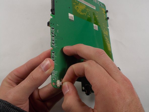

  9. Pandigital Novel PRD07T10WWH7 Speaker Replacement: crwdns2935265:09crwdnd2935265:01crwdnd2935265:03crwdne2935265:0 Pandigital Novel PRD07T10WWH7 Speaker Replacement: crwdns2935265:09crwdnd2935265:02crwdnd2935265:03crwdne2935265:0 Pandigital Novel PRD07T10WWH7 Speaker Replacement: crwdns2935265:09crwdnd2935265:03crwdnd2935265:03crwdne2935265:0
    • Unplug the speakers from the connectors on the motherboard.
