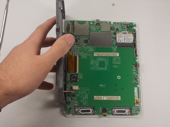

    • Carefully pry the back of the device from the front panel and motherboard. There are a series of clips holding them together that need to be separated.
  5. Pandigital Novel PRD07T10WWH7 Screen Replacement: crwdns2935265:05crwdnd2935265:01crwdnd2935265:01crwdne2935265:0
    • Now, lift up the gray piece, unplug the battery connector, so the gray piece will come free from the rest of the device.

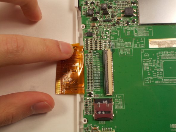

  6. Pandigital Novel PRD07T10WWH7 Screen Replacement: crwdns2935265:06crwdnd2935265:01crwdnd2935265:02crwdne2935265:0 Pandigital Novel PRD07T10WWH7 Screen Replacement: crwdns2935265:06crwdnd2935265:02crwdnd2935265:02crwdne2935265:0
    • Use the tip of your plastic spudger or your fingernail to flip up the long retaining flap. The longer, gold ribbon cable can now be pulled out safely.

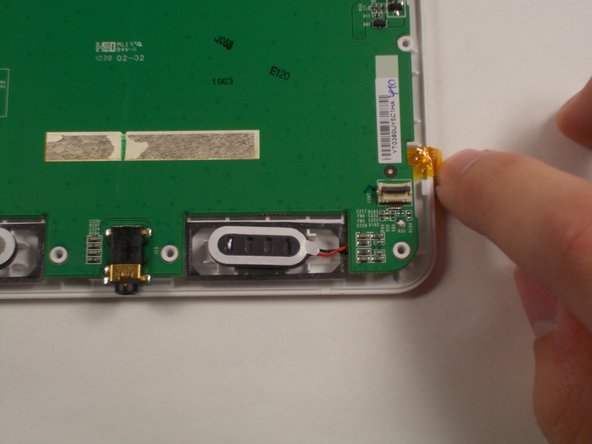

  7. Pandigital Novel PRD07T10WWH7 Screen Replacement: crwdns2935265:07crwdnd2935265:01crwdnd2935265:02crwdne2935265:0 Pandigital Novel PRD07T10WWH7 Screen Replacement: crwdns2935265:07crwdnd2935265:02crwdnd2935265:02crwdne2935265:0
    • Use the tip of your plastic spudger or your fingernail to flip up the shorter retaining flap. The smaller gold ribbon cable can now be pulled out safely.

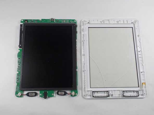

  8. Pandigital Novel PRD07T10WWH7 Screen Replacement: crwdns2935265:08crwdnd2935265:01crwdnd2935265:02crwdne2935265:0 Pandigital Novel PRD07T10WWH7 Screen Replacement: crwdns2935265:08crwdnd2935265:02crwdnd2935265:02crwdne2935265:0
    • Starting from the side of the device, lift the motherboard off of the plastic standoffs.
    • You will need to peel both speakers off of the device's plastic frame.

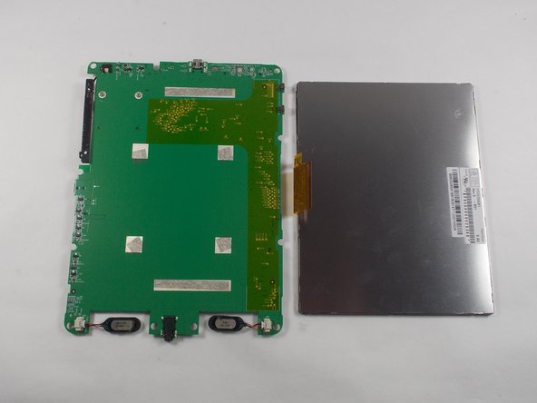

  9. Pandigital Novel PRD07T10WWH7 Screen Replacement: crwdns2935265:09crwdnd2935265:01crwdnd2935265:02crwdne2935265:0 Pandigital Novel PRD07T10WWH7 Screen Replacement: crwdns2935265:09crwdnd2935265:02crwdnd2935265:02crwdne2935265:0
    • With the screen facing up, use a plastic opening tool along the sides of the screen to pry it away from the motherboard.
    • There are six adhesive pads holding the display in place.
