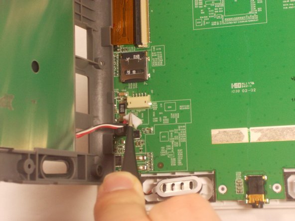

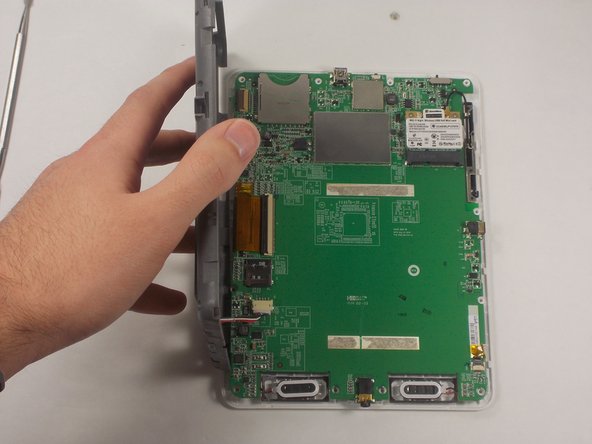

    • Pry the gray piece off of the motherboard.
    • Make sure the unplug the battery before you fully separate the gray piece.

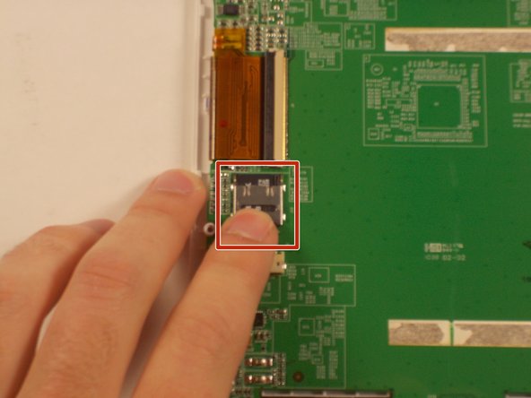

  4. Pandigital Novel PRD07T10WWH7 SD Card Replacement: crwdns2935265:04crwdnd2935265:01crwdnd2935265:02crwdne2935265:0 Pandigital Novel PRD07T10WWH7 SD Card Replacement: crwdns2935265:04crwdnd2935265:02crwdnd2935265:02crwdne2935265:0
    • Push upwards on the SD card slot to release it.

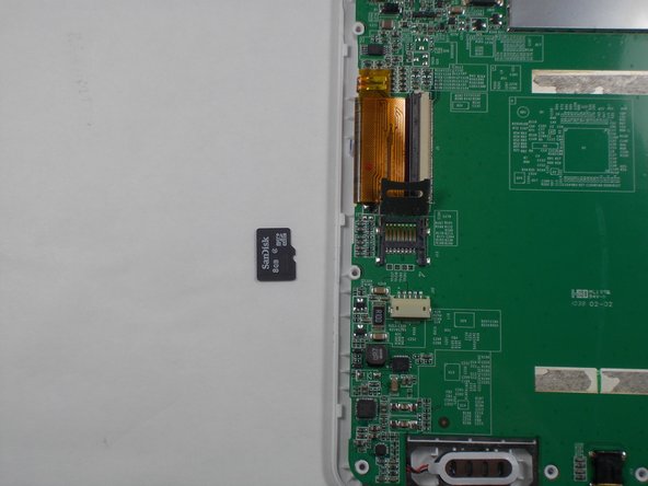

  5. Pandigital Novel PRD07T10WWH7 SD Card Replacement: crwdns2935265:05crwdnd2935265:01crwdnd2935265:02crwdne2935265:0 Pandigital Novel PRD07T10WWH7 SD Card Replacement: crwdns2935265:05crwdnd2935265:02crwdnd2935265:02crwdne2935265:0
    • The SD card can now be removed safely.
