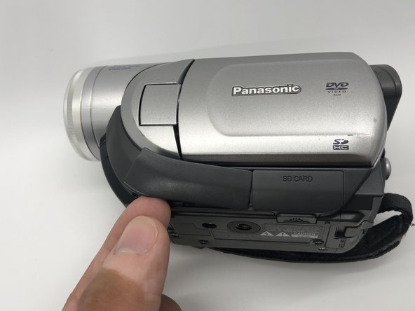

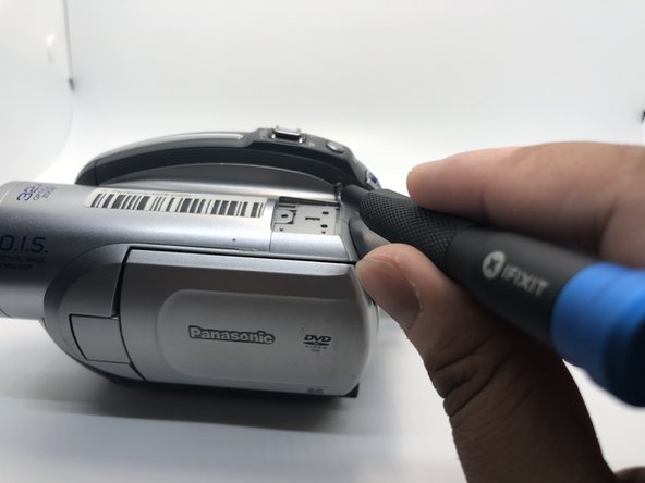

    • Use your Phillips #0 screwdriver to remove the three 5mm screws on top of the camera.
    • Remove the metal bracket.

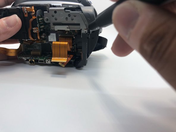

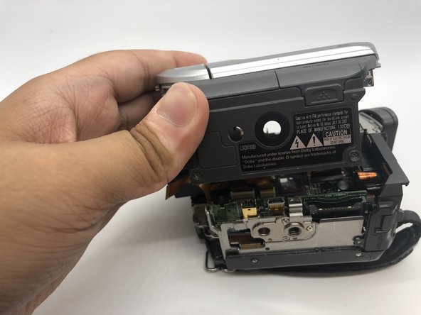

    • Use a spudger to pry the top-front part of the camera from the main body.
    • Gently slide the top portion of the camera forward reveling more screws.
    • Be sure not to slide the front portion too far, as there are still some cable connections joining the two portions.

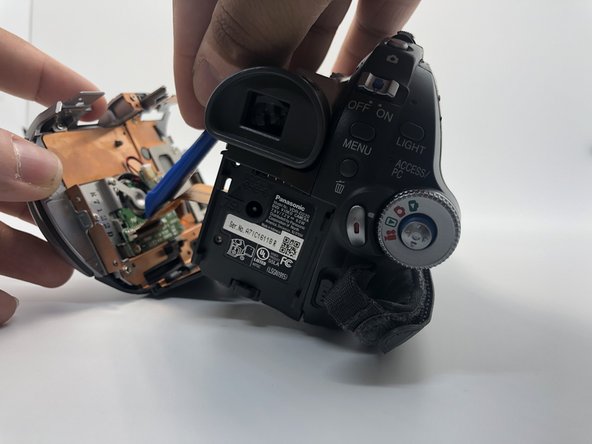

  5. Panasonic VDR-D220 DVD Viewfinder Replacement: crwdns2935265:05crwdnd2935265:01crwdnd2935265:03crwdne2935265:0 Panasonic VDR-D220 DVD Viewfinder Replacement: crwdns2935265:05crwdnd2935265:02crwdnd2935265:03crwdne2935265:0 Panasonic VDR-D220 DVD Viewfinder Replacement: crwdns2935265:05crwdnd2935265:03crwdnd2935265:03crwdne2935265:0

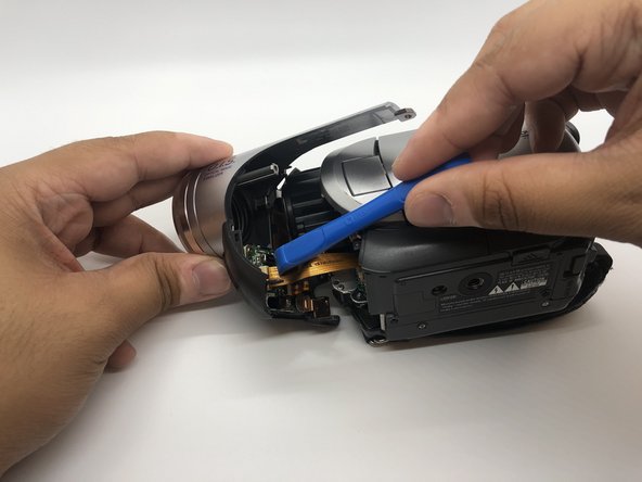

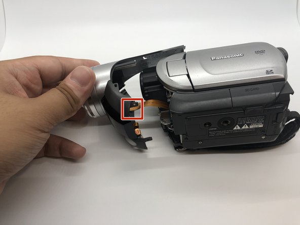

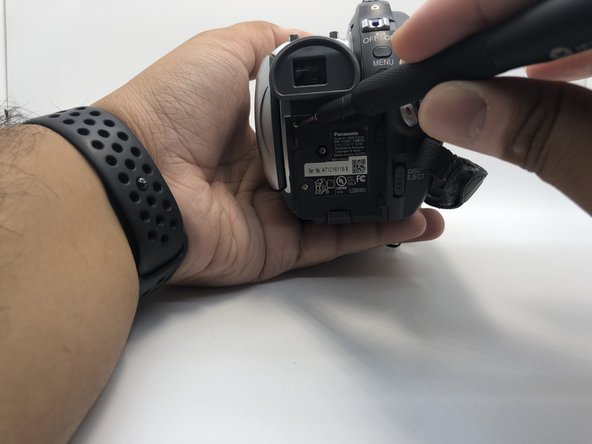

    • Flip the camera on the right side.
    • Gently pull the front part from the main body.
    • Do not pull too hard because of the ZIF connector cable.
    • Use the plastic opening tool to disconnect the connection point safely.
    • Press the tab with plastic opening tool and then pull the ZIF connector to detach.

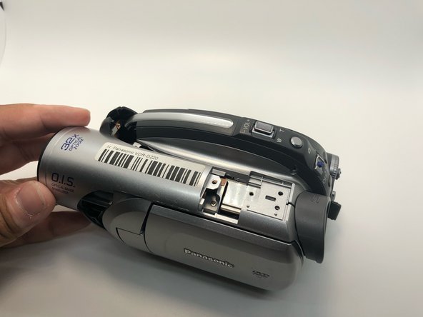

  8. Panasonic VDR-D220 DVD Viewfinder Replacement: crwdns2935265:08crwdnd2935265:01crwdnd2935265:03crwdne2935265:0 Panasonic VDR-D220 DVD Viewfinder Replacement: crwdns2935265:08crwdnd2935265:02crwdnd2935265:03crwdne2935265:0 Panasonic VDR-D220 DVD Viewfinder Replacement: crwdns2935265:08crwdnd2935265:03crwdnd2935265:03crwdne2935265:0

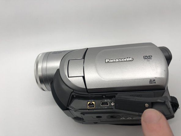

    • Rotate the camera to the left side, where the side port is located.
    • Open the side port door.
  9. Panasonic VDR-D220 DVD Viewfinder Replacement: crwdns2935265:09crwdnd2935265:01crwdnd2935265:03crwdne2935265:0 Panasonic VDR-D220 DVD Viewfinder Replacement: crwdns2935265:09crwdnd2935265:02crwdnd2935265:03crwdne2935265:0 Panasonic VDR-D220 DVD Viewfinder Replacement: crwdns2935265:09crwdnd2935265:03crwdnd2935265:03crwdne2935265:0

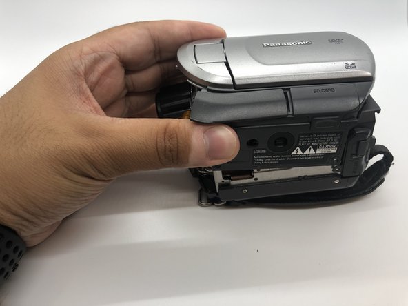

    • Remove three 5mm screws inside the side ports by using Phillips #0 screwdriver.

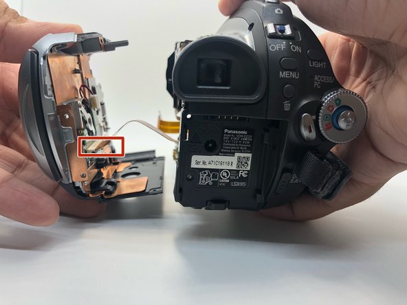

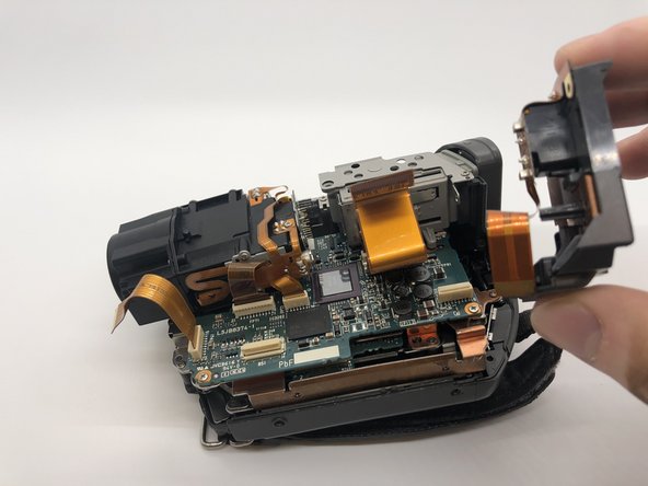

    • Begin to lift the left side of the camera from the main body.
    • Don't separate the camera sections too far, as there are more cable connections that need to be disconnected.
  10. Panasonic VDR-D220 DVD Viewfinder Replacement: crwdns2935265:010crwdnd2935265:01crwdnd2935265:03crwdne2935265:0 Panasonic VDR-D220 DVD Viewfinder Replacement: crwdns2935265:010crwdnd2935265:02crwdnd2935265:03crwdne2935265:0 Panasonic VDR-D220 DVD Viewfinder Replacement: crwdns2935265:010crwdnd2935265:03crwdnd2935265:03crwdne2935265:0

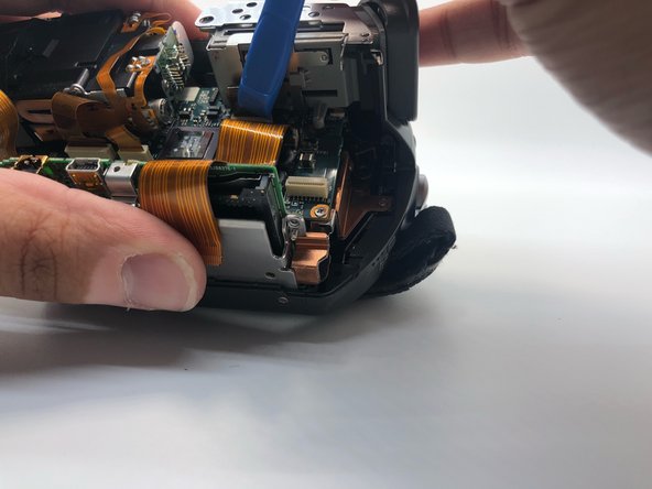

    • Rotate the camera to the battery side.
    • Gently pull the side of the camera apart until the cables are exposed.
    • Disconnect the ribbon cable with your plastic opening tool, so that the left side of the camera can be removed.

    • Remove another ribbon cable that runs from the viewfinder to the top of the motherboard. Use your plastic opening tool to disconnect the connection point safely.
