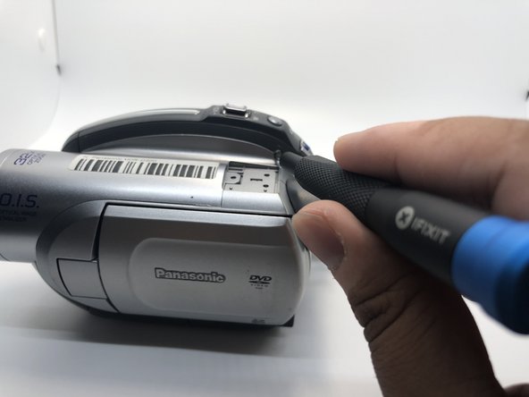

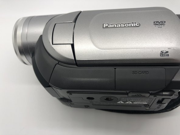

    • Remove all three 5mm screws from the top of the camera using a Phillips #0 screwdriver.

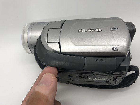

    • Rotate the camera to show the bottom side of the camera.
    • Remove the four 5mm screws on the bottom side of the camera with a Phillips #0 driver.

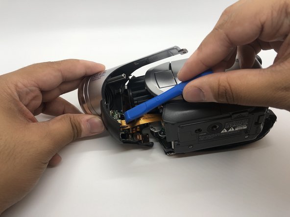

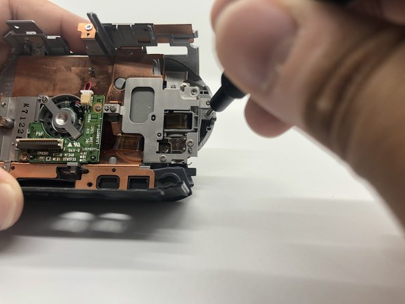

  4. Panasonic VDR-D220 DVD LCD Replacement: crwdns2935265:04crwdnd2935265:01crwdnd2935265:02crwdne2935265:0 Panasonic VDR-D220 DVD LCD Replacement: crwdns2935265:04crwdnd2935265:02crwdnd2935265:02crwdne2935265:0

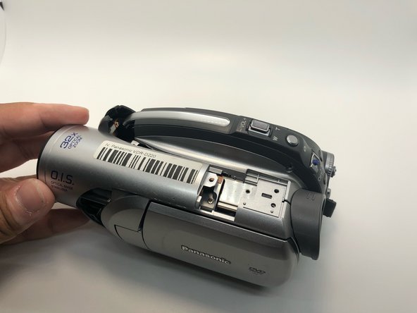

    • Pry with a spudger to disconnect the top-front part of the camera from the main body.
    • Slide the top portion of the camera forward revealing more screws.
    • Be careful not to remove the two sections too far as there are still cables connecting them.

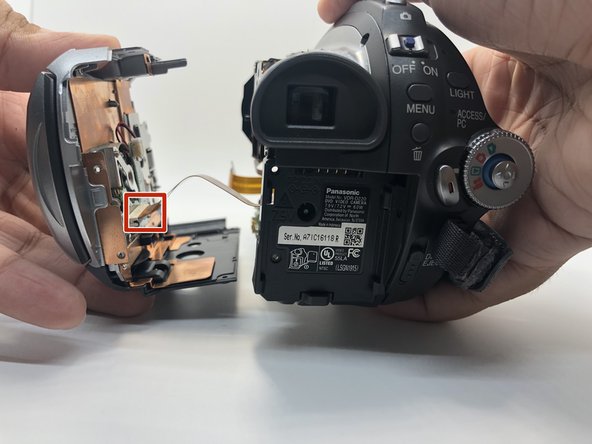

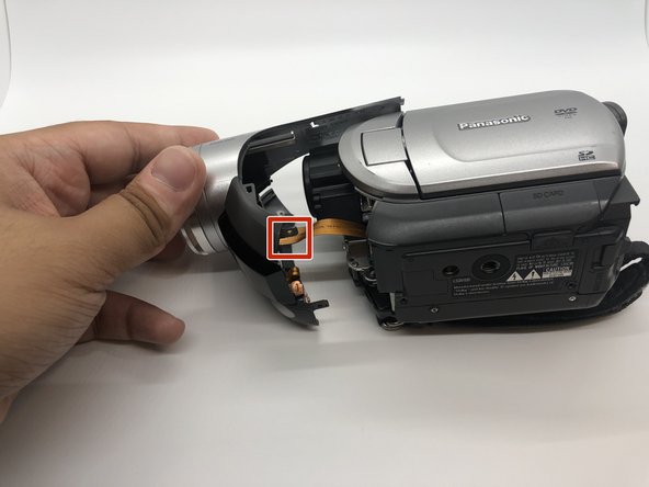

  5. Panasonic VDR-D220 DVD LCD Replacement: crwdns2935265:05crwdnd2935265:01crwdnd2935265:03crwdne2935265:0 Panasonic VDR-D220 DVD LCD Replacement: crwdns2935265:05crwdnd2935265:02crwdnd2935265:03crwdne2935265:0 Panasonic VDR-D220 DVD LCD Replacement: crwdns2935265:05crwdnd2935265:03crwdnd2935265:03crwdne2935265:0
    • Flip the camera on the right side.
    • Gently pull the front part from the main body to expose the cables connecting them.
    • Do not pull too hard because of the ZIF connector cable.
    • Use your plastic opening tool to disconnect the connection point safely.
    • Press the tab with plastic opening tool and then pull the ZIF connector to detach.

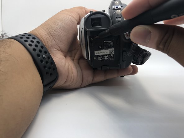

  6. Panasonic VDR-D220 DVD LCD Replacement: crwdns2935265:06crwdnd2935265:01crwdnd2935265:01crwdne2935265:0
    • Flip the camera on the bottom side.
    • Remove one more 5mm screw that had been uncovered previously with a Phillips #0 screwdriver.

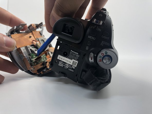

  10. Panasonic VDR-D220 DVD LCD Replacement: crwdns2935265:010crwdnd2935265:01crwdnd2935265:03crwdne2935265:0 Panasonic VDR-D220 DVD LCD Replacement: crwdns2935265:010crwdnd2935265:02crwdnd2935265:03crwdne2935265:0 Panasonic VDR-D220 DVD LCD Replacement: crwdns2935265:010crwdnd2935265:03crwdnd2935265:03crwdne2935265:0
    • Rotate the camera to the battery side.
    • Gently pull the side of the camera apart with only your hands.
    • Disconnect the ribbon cable with your plastic opening tool, so that the left side of the camera can be removed.

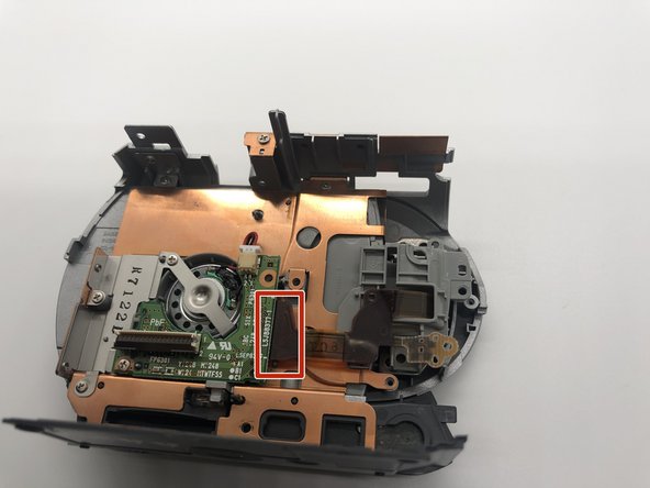

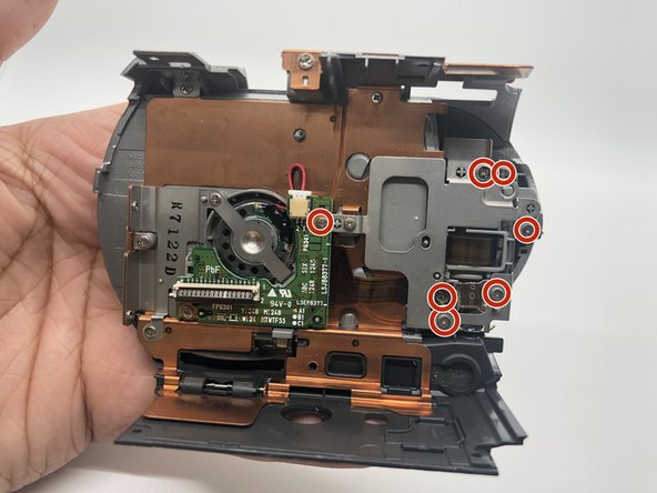

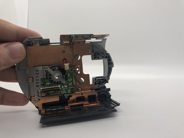

  12. Panasonic VDR-D220 DVD LCD Replacement: crwdns2935265:012crwdnd2935265:01crwdnd2935265:03crwdne2935265:0 Panasonic VDR-D220 DVD LCD Replacement: crwdns2935265:012crwdnd2935265:02crwdnd2935265:03crwdne2935265:0 Panasonic VDR-D220 DVD LCD Replacement: crwdns2935265:012crwdnd2935265:03crwdnd2935265:03crwdne2935265:0
    • Take off the metal piece.
    • Use your plastic opening tool to disconnect the ribbon cable. Press the tab with plastic opening tool and then pull the ZIF connector to detach.

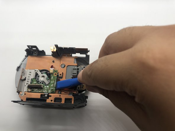

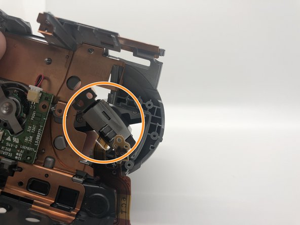

  13. Panasonic VDR-D220 DVD LCD Replacement: crwdns2935265:013crwdnd2935265:01crwdnd2935265:01crwdne2935265:0
    • Use a plastic spudger to apply a firm amount of pressure to pry the hinge from the rest of the camera body.

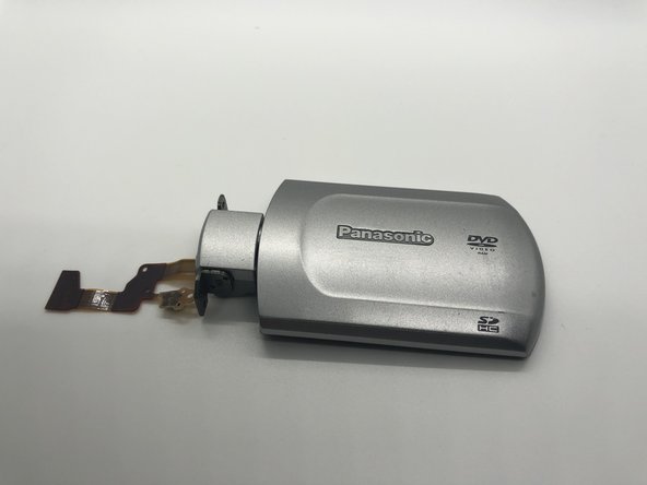

  14. Panasonic VDR-D220 DVD LCD Replacement: crwdns2935265:014crwdnd2935265:01crwdnd2935265:03crwdne2935265:0 Panasonic VDR-D220 DVD LCD Replacement: crwdns2935265:014crwdnd2935265:02crwdnd2935265:03crwdne2935265:0 Panasonic VDR-D220 DVD LCD Replacement: crwdns2935265:014crwdnd2935265:03crwdnd2935265:03crwdne2935265:0
    • Go back to the back side.
    • Take off the small plastic piece.
    • Pay attention to the ribbon cable because it goes through the plastic piece.
    • Rotate the right side of the LCD counter clockwise.
    • Left side of the camera after LCD is removed.
  15. Panasonic VDR-D220 DVD LCD Replacement: crwdns2935265:015crwdnd2935265:01crwdnd2935265:02crwdne2935265:0 Panasonic VDR-D220 DVD LCD Replacement: crwdns2935265:015crwdnd2935265:02crwdnd2935265:02crwdne2935265:0
    • LCD replacement part.
