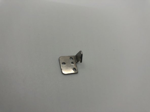

    • The DVD's door can be opened by pressing the top-left of the DVD's door.
    • If this doesn’t work, you may need to manually eject.
    • Use the plastic spudger with light force to carefully pry open the door.
    • Open the disk ejection slot gently.
  2. Panasonic VDR-D220 DVD Disk Latch Replacement: crwdns2935265:02crwdnd2935265:01crwdnd2935265:03crwdne2935265:0 Panasonic VDR-D220 DVD Disk Latch Replacement: crwdns2935265:02crwdnd2935265:02crwdnd2935265:03crwdne2935265:0 Panasonic VDR-D220 DVD Disk Latch Replacement: crwdns2935265:02crwdnd2935265:03crwdnd2935265:03crwdne2935265:0
    • Remove the two 5mm screws on the top-right corner of the disk slot using Phillips #0 screwdriver.
  3. Panasonic VDR-D220 DVD Disk Latch Replacement: crwdns2935265:03crwdnd2935265:01crwdnd2935265:02crwdne2935265:0 Panasonic VDR-D220 DVD Disk Latch Replacement: crwdns2935265:03crwdnd2935265:02crwdnd2935265:02crwdne2935265:0
    • Carefully remove the chip.
    • The disk is completely replaced/removed.
