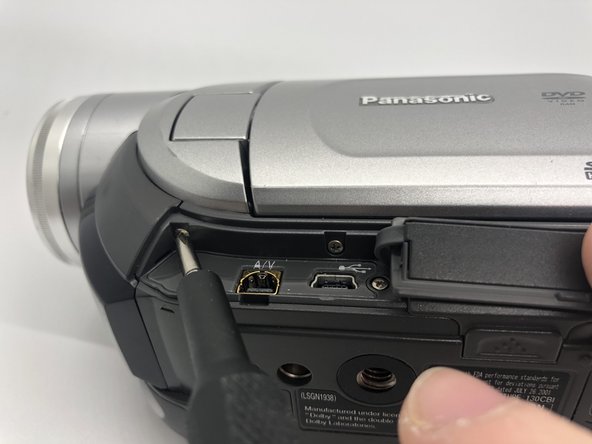

    • Open the side port door.
  3. Panasonic VDR-D220 DVD Camera Front lens Element Replacement: crwdns2935265:03crwdnd2935265:01crwdnd2935265:02crwdne2935265:0 Panasonic VDR-D220 DVD Camera Front lens Element Replacement: crwdns2935265:03crwdnd2935265:02crwdnd2935265:02crwdne2935265:0
    • Remove one 5mm screw inside the side port with your Phillips #0 screwdriver.

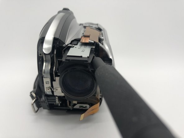

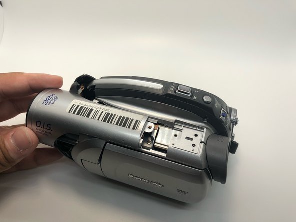

    • Using a plastic spudger, pry to disconnect the top-front part of the camera.
    • Slide the top portion of the camera forward revealing a ribbon cable.

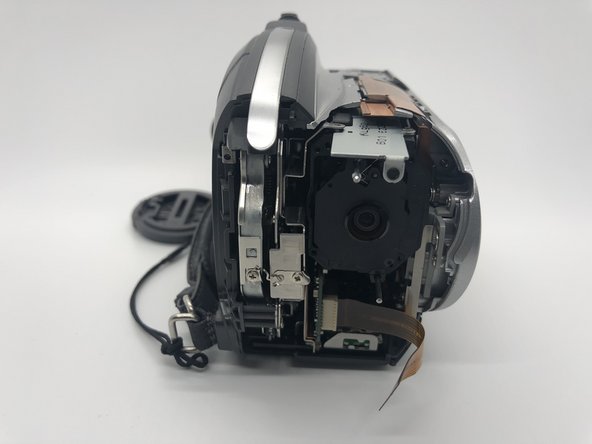

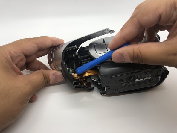

  5. Panasonic VDR-D220 DVD Camera Front lens Element Replacement: crwdns2935265:05crwdnd2935265:01crwdnd2935265:03crwdne2935265:0 Panasonic VDR-D220 DVD Camera Front lens Element Replacement: crwdns2935265:05crwdnd2935265:02crwdnd2935265:03crwdne2935265:0 Panasonic VDR-D220 DVD Camera Front lens Element Replacement: crwdns2935265:05crwdnd2935265:03crwdnd2935265:03crwdne2935265:0

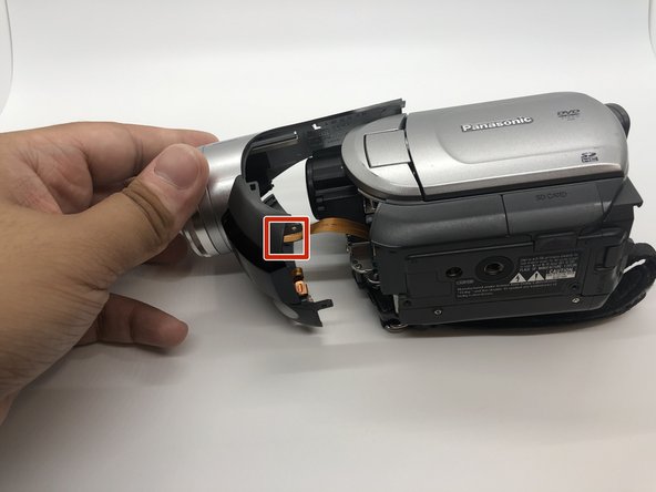

    • Flip the camera on the right side.
    • Gently pull the front part from the main body to reveal the cables connecting them.
    • Do not pull too hard because of the ZIF connector cable.
    • Use your plastic opening tool to disconnect the connection point safely.
    • Press the tab with a plastic opening tool and then pull the ZIF connector to detach.

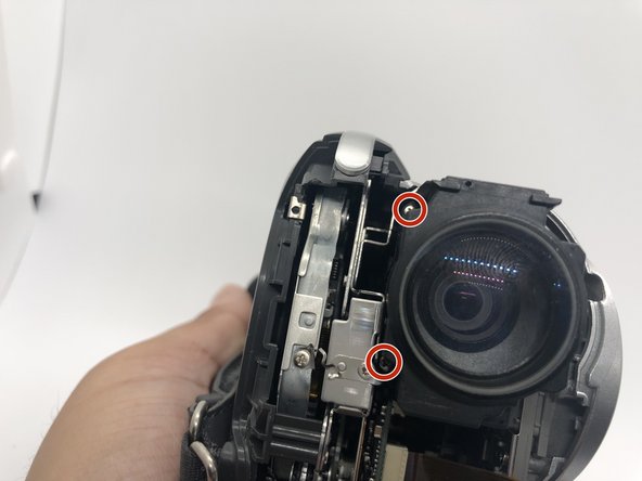

  6. Panasonic VDR-D220 DVD Camera Front lens Element Replacement: crwdns2935265:06crwdnd2935265:01crwdnd2935265:03crwdne2935265:0 Panasonic VDR-D220 DVD Camera Front lens Element Replacement: crwdns2935265:06crwdnd2935265:02crwdnd2935265:03crwdne2935265:0 Panasonic VDR-D220 DVD Camera Front lens Element Replacement: crwdns2935265:06crwdnd2935265:03crwdnd2935265:03crwdne2935265:0
    • Look at the camera from the front side.
    • Remove four 5mm screws using a Phillips #0 screwdriver.
    • There are two 5mm screws on each side of the lens, for a total of four screws.

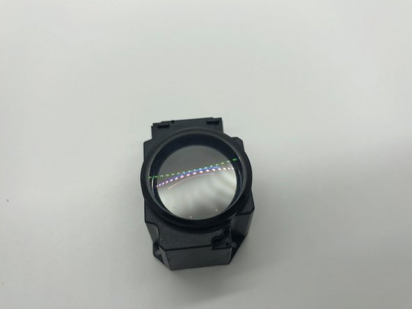

  7. Panasonic VDR-D220 DVD Camera Front lens Element Replacement: crwdns2935265:07crwdnd2935265:01crwdnd2935265:03crwdne2935265:0 Panasonic VDR-D220 DVD Camera Front lens Element Replacement: crwdns2935265:07crwdnd2935265:02crwdnd2935265:03crwdne2935265:0 Panasonic VDR-D220 DVD Camera Front lens Element Replacement: crwdns2935265:07crwdnd2935265:03crwdnd2935265:03crwdne2935265:0
    • Pull the front element lens gently away from the camera.
    • In some cases the lens need not be replaced completely. Sometimes cleaning the lens with a microfiber cloth and isopropyl alcohol will alleviate blurry video issues.
