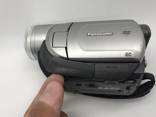

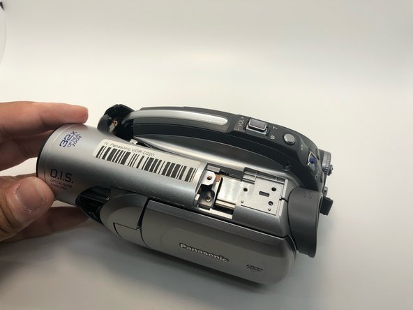

    • Use your Phillips #0 screwdriver to remove the three 5mm screws on top of the camera.
    • Remove the metal bracket.
  2. Panasonic VDR-D220 DVD AV and Micro USB Data Ports Replacement: crwdns2935265:02crwdnd2935265:01crwdnd2935265:02crwdne2935265:0 Panasonic VDR-D220 DVD AV and Micro USB Data Ports Replacement: crwdns2935265:02crwdnd2935265:02crwdnd2935265:02crwdne2935265:0

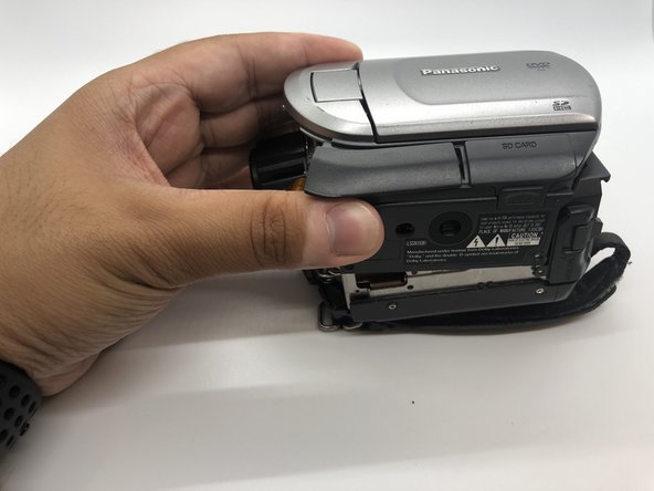

    • Rotate the camera to show the bottom of the camera.
    • Remove the four 5mm screws on the bottom side of the camera with a Phillips #0 driver.
  3. Panasonic VDR-D220 DVD AV and Micro USB Data Ports Replacement: crwdns2935265:03crwdnd2935265:01crwdnd2935265:02crwdne2935265:0 Panasonic VDR-D220 DVD AV and Micro USB Data Ports Replacement: crwdns2935265:03crwdnd2935265:02crwdnd2935265:02crwdne2935265:0
    • Rotate the camera to the left side. There is one screw on the top right of metal bracket you have removed in step 1.
    • Remove one 5mm screw by using Phillips #0 screwdriver.

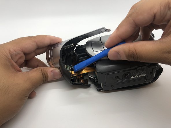

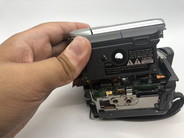

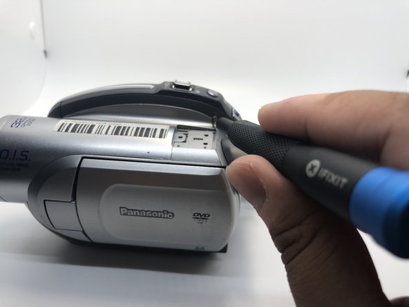

  4. Panasonic VDR-D220 DVD AV and Micro USB Data Ports Replacement: crwdns2935265:04crwdnd2935265:01crwdnd2935265:02crwdne2935265:0 Panasonic VDR-D220 DVD AV and Micro USB Data Ports Replacement: crwdns2935265:04crwdnd2935265:02crwdnd2935265:02crwdne2935265:0
    • Use a plastic spudger to lighty pry the top-front panel of the camera from the main body.
    • Slide the top portion of the camera forward revealing more screws.
    • Do not completely separate the top portion yet, as there are cable connections that remain.

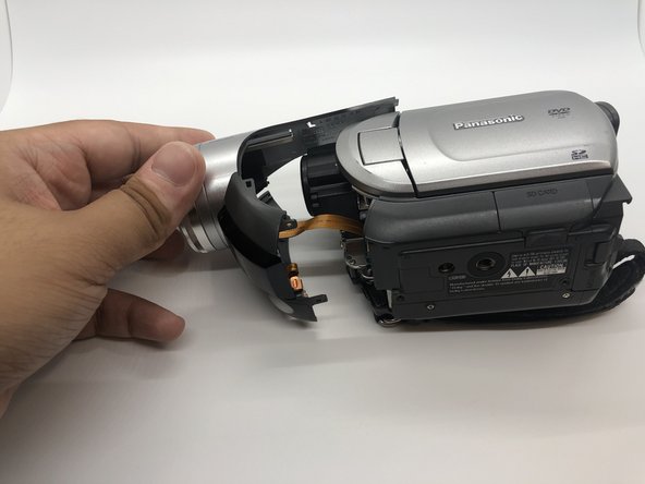

  5. Panasonic VDR-D220 DVD AV and Micro USB Data Ports Replacement: crwdns2935265:05crwdnd2935265:01crwdnd2935265:03crwdne2935265:0 Panasonic VDR-D220 DVD AV and Micro USB Data Ports Replacement: crwdns2935265:05crwdnd2935265:02crwdnd2935265:03crwdne2935265:0 Panasonic VDR-D220 DVD AV and Micro USB Data Ports Replacement: crwdns2935265:05crwdnd2935265:03crwdnd2935265:03crwdne2935265:0
    • Flip the camera on the right side.
    • Gently pull the front part from the main body to expose the cable connections.
    • Pulling too hard or fast has the potential to damage the ZIF connector cable.
    • Use your plastic opening tool to disconnect the connection point safely.
    • Press the tab with plastic opening tool and then pull the ZIF connector to detach.

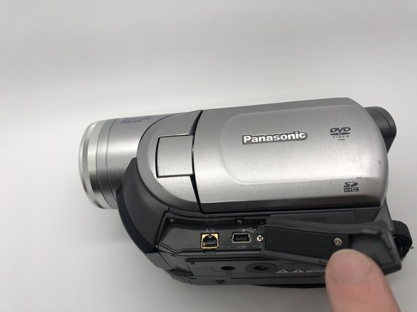

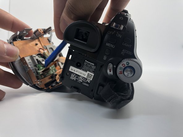

    • Rotate the camera to the left side, where the side port is located.
    • Open the side port door.
  9. Panasonic VDR-D220 DVD AV and Micro USB Data Ports Replacement: crwdns2935265:09crwdnd2935265:01crwdnd2935265:03crwdne2935265:0 Panasonic VDR-D220 DVD AV and Micro USB Data Ports Replacement: crwdns2935265:09crwdnd2935265:02crwdnd2935265:03crwdne2935265:0 Panasonic VDR-D220 DVD AV and Micro USB Data Ports Replacement: crwdns2935265:09crwdnd2935265:03crwdnd2935265:03crwdne2935265:0
    • Remove three 5mm screws inside the side ports by using Phillips #0 screwdriver.
    • Start to lift the lefthand section of the camera from the main body.
    • Don't fully remove the section just yet as there are cable connections that remain.

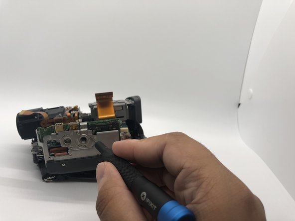

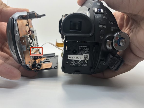

  10. Panasonic VDR-D220 DVD AV and Micro USB Data Ports Replacement: crwdns2935265:010crwdnd2935265:01crwdnd2935265:03crwdne2935265:0 Panasonic VDR-D220 DVD AV and Micro USB Data Ports Replacement: crwdns2935265:010crwdnd2935265:02crwdnd2935265:03crwdne2935265:0 Panasonic VDR-D220 DVD AV and Micro USB Data Ports Replacement: crwdns2935265:010crwdnd2935265:03crwdnd2935265:03crwdne2935265:0
    • Rotate the camera to the battery side.

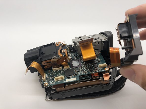

    • Gently, pull the side of the camera apart with only your hands.
    • Do not pull too hard because of the ZIF connector cable.
    • Disconnect the ribbon cable with your plastic opening tool, so that the left side of the camera can be removed.

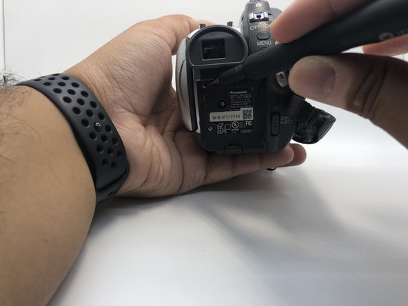

  11. Panasonic VDR-D220 DVD AV and Micro USB Data Ports Replacement: crwdns2935265:011crwdnd2935265:01crwdnd2935265:02crwdne2935265:0 Panasonic VDR-D220 DVD AV and Micro USB Data Ports Replacement: crwdns2935265:011crwdnd2935265:02crwdnd2935265:02crwdne2935265:0
    • Remove one 5mm screw from the side of the battery base with the Phillips #0 screwdriver.
    • Take off the battery's base from the camera.

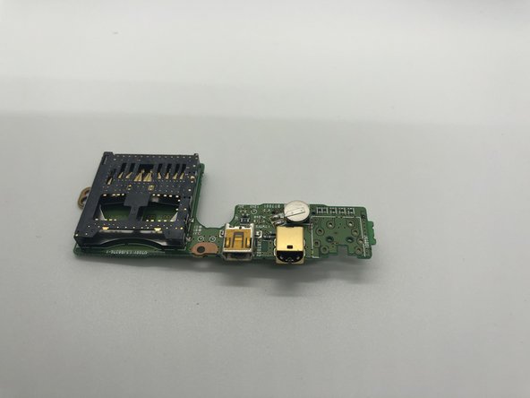

  13. Panasonic VDR-D220 DVD AV and Micro USB Data Ports Replacement: crwdns2935265:013crwdnd2935265:01crwdnd2935265:02crwdne2935265:0 Panasonic VDR-D220 DVD AV and Micro USB Data Ports Replacement: crwdns2935265:013crwdnd2935265:02crwdnd2935265:02crwdne2935265:0
    • Insert a Jimmy tool to relieve the pressure between the metal mount and the plastic cover.

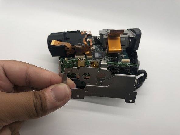

    • Take off the port board from the bottom of the camera.

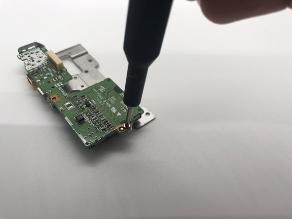

  14. Panasonic VDR-D220 DVD AV and Micro USB Data Ports Replacement: crwdns2935265:014crwdnd2935265:01crwdnd2935265:03crwdne2935265:0 Panasonic VDR-D220 DVD AV and Micro USB Data Ports Replacement: crwdns2935265:014crwdnd2935265:02crwdnd2935265:03crwdne2935265:0 Panasonic VDR-D220 DVD AV and Micro USB Data Ports Replacement: crwdns2935265:014crwdnd2935265:03crwdnd2935265:03crwdne2935265:0

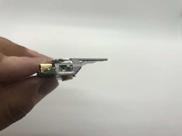

    • Use your Phillips #0 screwdriver remove one 5mm screw from one side of the port.
    • On the other side, disconnect the metal from the port circuit board smoothly.
  15. Panasonic VDR-D220 DVD AV and Micro USB Data Ports Replacement: crwdns2935265:015crwdnd2935265:01crwdnd2935265:02crwdne2935265:0 Panasonic VDR-D220 DVD AV and Micro USB Data Ports Replacement: crwdns2935265:015crwdnd2935265:02crwdnd2935265:02crwdne2935265:0
    • Remove the metal cover from the side port.
