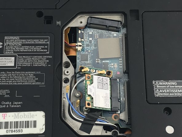

    • Turn the laptop to its back side and align it so that the handle is facing away from you.
    • Remove the single 4 mm Phillips #00 screw from the Wi-Fi card/optical drive cover and remove the plastic cover.
    • The Wi-Fi card is located closest to you , below the little strip-sized circuit board.

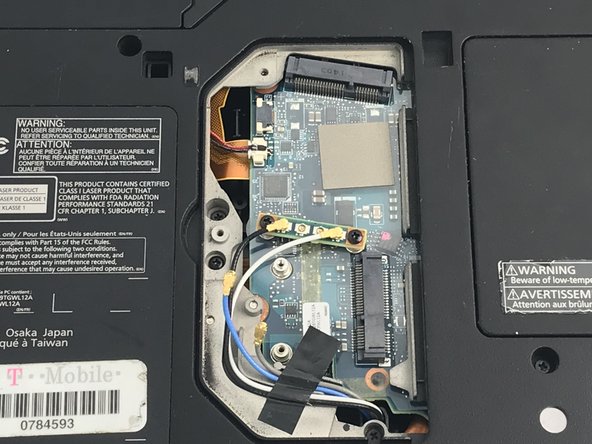

  2. Panasonic Toughbook CF-53 Wi-Fi Card Replacement: crwdns2935265:02crwdnd2935265:01crwdnd2935265:02crwdne2935265:0 Panasonic Toughbook CF-53 Wi-Fi Card Replacement: crwdns2935265:02crwdnd2935265:02crwdnd2935265:02crwdne2935265:0
    • Very gently pry up on the two connectors attached to the Wi-Fi card using the flat end of a spudger.
    • It is very important to be careful with these connectors because they are difficult to replace or repair.
    • Once both connectors have been detached, carefully hold the wires back to have access to the Wi-Fi card.
  3. Panasonic Toughbook CF-53 Wi-Fi Card Replacement: crwdns2935265:03crwdnd2935265:01crwdnd2935265:03crwdne2935265:0 Panasonic Toughbook CF-53 Wi-Fi Card Replacement: crwdns2935265:03crwdnd2935265:02crwdnd2935265:03crwdne2935265:0 Panasonic Toughbook CF-53 Wi-Fi Card Replacement: crwdns2935265:03crwdnd2935265:03crwdnd2935265:03crwdne2935265:0
    • Remove the two 4 mm Phillips #00 screws that secure the card to the board.
    • Gently lift the card up and pull it out of its connection slot.
    • The Wi-Fi card is now removed.
    • When inserting the new Wi-Fi card into the connection slot, place the card at a 40 degree angle and push it all the way back, then lay it flat.
