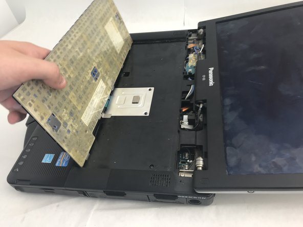

  3. Panasonic Toughbook CF-53 Keyboard Replacement: crwdns2935265:03crwdnd2935265:01crwdnd2935265:03crwdne2935265:0 Panasonic Toughbook CF-53 Keyboard Replacement: crwdns2935265:03crwdnd2935265:02crwdnd2935265:03crwdne2935265:0 Panasonic Toughbook CF-53 Keyboard Replacement: crwdns2935265:03crwdnd2935265:03crwdnd2935265:03crwdne2935265:0
    • Gently pull up on the keyboard from the top.
    • There is an adhesive securing the keyboard in place. You will need to break that in order to remove the keyboard.
    • Fold the keyboard over and lay it flat on the keys so that you can access the panel under it.

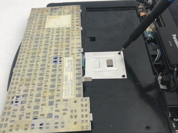

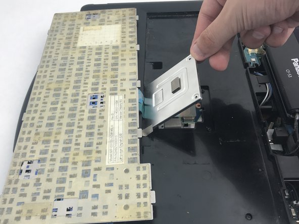

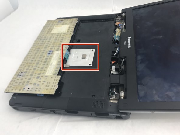

  4. Panasonic Toughbook CF-53 Keyboard Replacement: crwdns2935265:04crwdnd2935265:01crwdnd2935265:03crwdne2935265:0 Panasonic Toughbook CF-53 Keyboard Replacement: crwdns2935265:04crwdnd2935265:02crwdnd2935265:03crwdne2935265:0 Panasonic Toughbook CF-53 Keyboard Replacement: crwdns2935265:04crwdnd2935265:03crwdnd2935265:03crwdne2935265:0

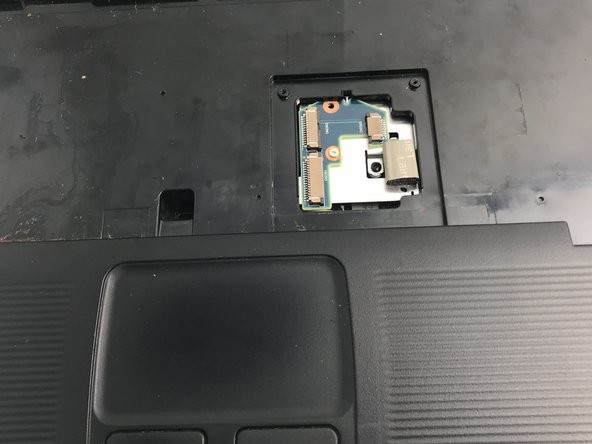

    • Remove the two 3 mm Phillips #00 screws securing the aluminum plate to the laptop.
    • Use an opening tool or your hands to lift up and remove the cover plate.

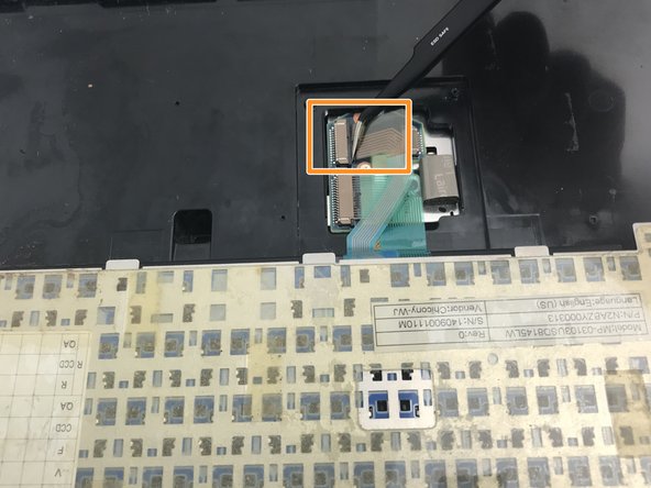

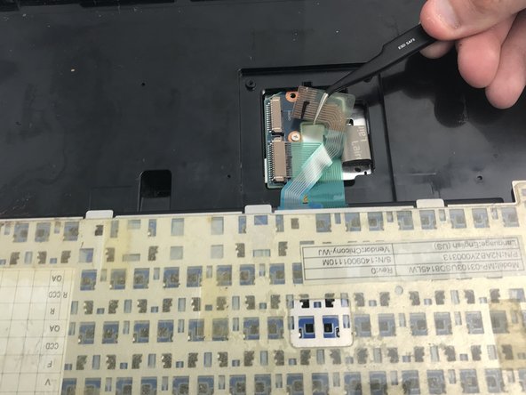

  5. Panasonic Toughbook CF-53 Keyboard Replacement: crwdns2935265:05crwdnd2935265:01crwdnd2935265:03crwdne2935265:0 Panasonic Toughbook CF-53 Keyboard Replacement: crwdns2935265:05crwdnd2935265:02crwdnd2935265:03crwdne2935265:0 Panasonic Toughbook CF-53 Keyboard Replacement: crwdns2935265:05crwdnd2935265:03crwdnd2935265:03crwdne2935265:0
    • Use the tweezers to gently pull the top ribbon connection from its slot.
    • If the keyboard has never been replaced before, there will be an adhesive securing the ribbon connections to the laptop. Make sure to gently break the adhesive by pulling up on the connections with the tweezers.

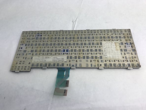

  6. Panasonic Toughbook CF-53 Keyboard Replacement: crwdns2935265:06crwdnd2935265:01crwdnd2935265:03crwdne2935265:0 Panasonic Toughbook CF-53 Keyboard Replacement: crwdns2935265:06crwdnd2935265:02crwdnd2935265:03crwdne2935265:0 Panasonic Toughbook CF-53 Keyboard Replacement: crwdns2935265:06crwdnd2935265:03crwdnd2935265:03crwdne2935265:0
    • With the top ribbon connection folded back, use the tweezers to carefully remove the bottom ribbon connection.
    • Break any adhesives holding the ribbon connections to the laptop and pull them away so that the keyboard can be removed.
