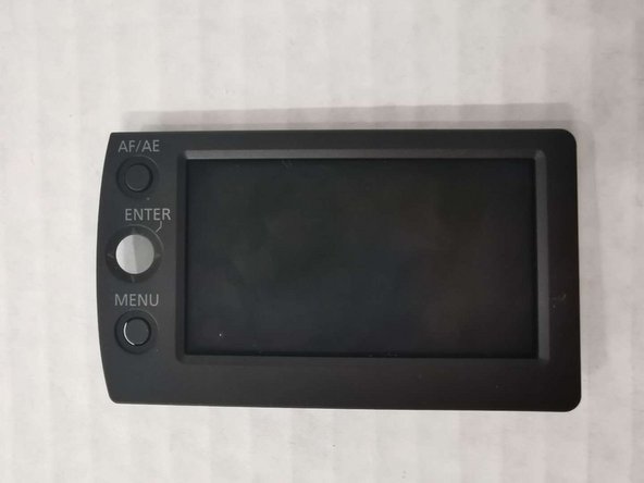

    1. Panasonic SDR-H85 LCD Replacement, LCD Screen: crwdns2935265:02crwdnd2935265:01crwdnd2935265:02crwdne2935265:0 Panasonic SDR-H85 LCD Replacement, LCD Screen: crwdns2935265:02crwdnd2935265:02crwdnd2935265:02crwdne2935265:0
      • Use a Phillips #00 screwdriver to remove two screws from behind the corners of the display screen.

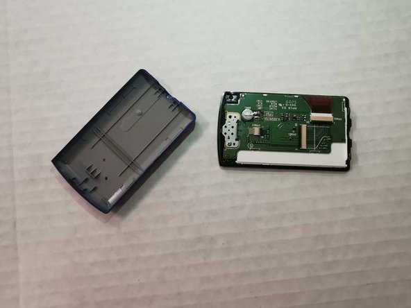

    2. Panasonic SDR-H85 LCD Replacement: crwdns2935265:03crwdnd2935265:01crwdnd2935265:02crwdne2935265:0 Panasonic SDR-H85 LCD Replacement: crwdns2935265:03crwdnd2935265:02crwdnd2935265:02crwdne2935265:0
      • Open the case carefully. Make sure to disconnect the parts.
    3. Panasonic SDR-H85 LCD Replacement: crwdns2935265:04crwdnd2935265:01crwdnd2935265:01crwdne2935265:0
      • Use a Phillips #00 screwdriver to remove one screw on the green panel.

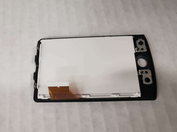

    4. Panasonic SDR-H85 LCD Replacement: crwdns2935265:05crwdnd2935265:01crwdnd2935265:03crwdne2935265:0 Panasonic SDR-H85 LCD Replacement: crwdns2935265:05crwdnd2935265:02crwdnd2935265:03crwdne2935265:0 Panasonic SDR-H85 LCD Replacement: crwdns2935265:05crwdnd2935265:03crwdnd2935265:03crwdne2935265:0
      • Disconnect the panel from the screen part.
