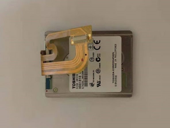

    • This step needs to be done very slowly and carefully due to the delicate hard drive ribbon cable.
    • Open the camera cover slowly and enough to see the orange ribbon cable. Do not pull to release the ribbon cable from the hard drive.
    • Gently detach the connection of the ribbon cable from the hard drive by using the spudger to drive a wedge between the ribbon cable and the hard drive itself.
    • Do not use excessive force on the ribbon cable due to its delicate nature. You should feel a click when the connection has been broken.
  6. Panasonic SDR-H85 Hard Drive Replacement: crwdns2935265:06crwdnd2935265:01crwdnd2935265:03crwdne2935265:0 Panasonic SDR-H85 Hard Drive Replacement: crwdns2935265:06crwdnd2935265:02crwdnd2935265:03crwdne2935265:0 Panasonic SDR-H85 Hard Drive Replacement: crwdns2935265:06crwdnd2935265:03crwdnd2935265:03crwdne2935265:0
    • Remove three Phillips #00 screws from the interior of the camera.
    • Carefully pull out the hard drive from both the top and the bottom in alternative moves, first from the top and then from the bottom.
    • Use slight force because the rubber lining around the hard drive is very secure.
    • Remove the rubber lining of the hard drive.
    • Make sure you remove the rubber lining carefully as it could pop through and potentially hit you.
