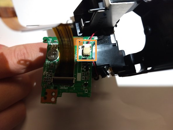

  5. Panasonic SDR-H40P SD Card slot Replacement, Motherboard: crwdns2935265:05crwdnd2935265:01crwdnd2935265:02crwdne2935265:0 Panasonic SDR-H40P SD Card slot Replacement, Motherboard: crwdns2935265:05crwdnd2935265:02crwdnd2935265:02crwdne2935265:0
    • Remove the screws circled.
    • Pull front section away from the rest of the camera to remove it.
    • Front panel has a ribbon cable that's attached to the motherboard. Detach the motherboard end when pulling off the front panel.
  6. Panasonic SDR-H40P SD Card slot Replacement: crwdns2935265:06crwdnd2935265:01crwdnd2935265:03crwdne2935265:0 Panasonic SDR-H40P SD Card slot Replacement: crwdns2935265:06crwdnd2935265:02crwdnd2935265:03crwdne2935265:0 Panasonic SDR-H40P SD Card slot Replacement: crwdns2935265:06crwdnd2935265:03crwdnd2935265:03crwdne2935265:0
    • Carefully pull the motherboard away from the the rest of the camera.
    • Detach the ribbon cables from the motherboard.
    • Be careful with the ribbon cables they applying too much force could damage them.

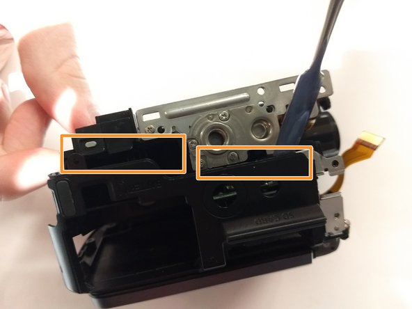

  7. Panasonic SDR-H40P SD Card slot Replacement, Camera assembly: crwdns2935265:07crwdnd2935265:01crwdnd2935265:02crwdne2935265:0 Panasonic SDR-H40P SD Card slot Replacement, Camera assembly: crwdns2935265:07crwdnd2935265:02crwdnd2935265:02crwdne2935265:0
    • Remove screw circled.
    • Use a spatula to pull up the black shell and pull it away from the rest of the camera

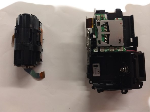

  8. Panasonic SDR-H40P SD Card slot Replacement: crwdns2935265:08crwdnd2935265:01crwdnd2935265:02crwdne2935265:0 Panasonic SDR-H40P SD Card slot Replacement: crwdns2935265:08crwdnd2935265:02crwdnd2935265:02crwdne2935265:0
    • Remove the screw circled.
    • Feed the ribbon cable when pulling out the lens. There is a hole where the cable goes through. Do this before moving the lens.

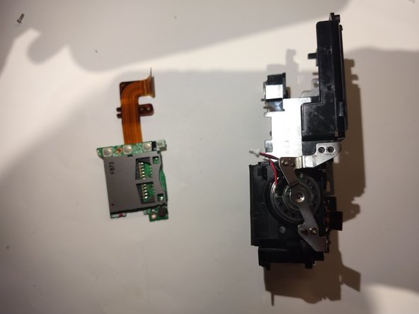

  9. Panasonic SDR-H40P SD Card slot Replacement, SD Card slot: crwdns2935265:09crwdnd2935265:01crwdnd2935265:03crwdne2935265:0 Panasonic SDR-H40P SD Card slot Replacement, SD Card slot: crwdns2935265:09crwdnd2935265:02crwdnd2935265:03crwdne2935265:0 Panasonic SDR-H40P SD Card slot Replacement, SD Card slot: crwdns2935265:09crwdnd2935265:03crwdnd2935265:03crwdne2935265:0
    • Remove the two screws using a Phillips #00 screwdriver.
    • Use tweezers to slowly pull out the cable.
    • Pulling directly on the cord could lead to damaging the wire.
