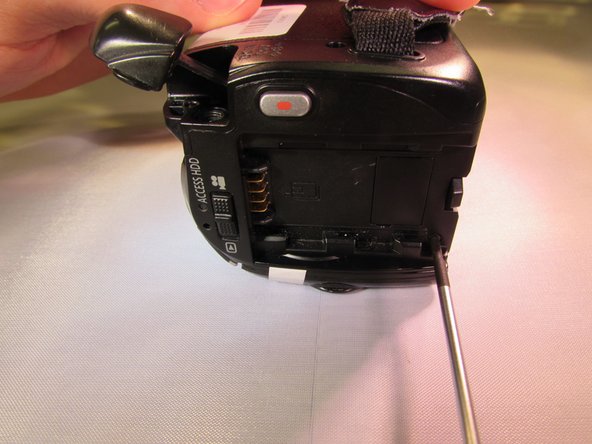

    • Remove the four 4-mm screws on the bottom of the camcorder.
    • The screws are two different colors: three blacks and one silver.

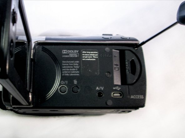

  2. Panasonic SDR H-100 Zoom Lever Replacement, Remove Side Screws: crwdns2935265:02crwdnd2935265:01crwdnd2935265:01crwdne2935265:0
    • Remove the three 6-mm screws on the hand-strap side of the camera.
  3. Panasonic SDR H-100 Zoom Lever Replacement, Remove DC Input Terminal Screws: crwdns2935265:03crwdnd2935265:01crwdnd2935265:01crwdne2935265:0
    • Pull out the charging port (DC input terminal) cover and remove the 4-mm screw located next to the input terminal.
  4. Panasonic SDR H-100 Zoom Lever Replacement, Remove LCD Monitor Screws: crwdns2935265:04crwdnd2935265:01crwdnd2935265:02crwdne2935265:0 Panasonic SDR H-100 Zoom Lever Replacement, Remove LCD Monitor Screws: crwdns2935265:04crwdnd2935265:02crwdnd2935265:02crwdne2935265:0
    • Flip out the LCD screen to expose the inner screws. Remove the two black 4-mm screws.
    • One screw is located by the hinge of the LCD screen. The second is close to the upper-right corner of the camcorder body.

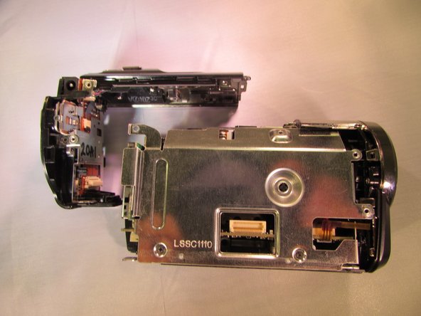

    • Using a firm hold on both sides of the camcorder, gently pull apart the casing under the hand strap.
    • Pressure should be evenly distributed across entire device.
    • Detach gently so the ribbon cable is not damaged!
  5. Panasonic SDR H-100 Zoom Lever Replacement, Detach Ribbon Cable from Body: crwdns2935265:06crwdnd2935265:01crwdnd2935265:01crwdne2935265:0
    • Use tweezers to grab the ribbon cable at the connection point and slowly lift it away from the connector.
    • This linkage point connects the HDD directly to the motherboard.

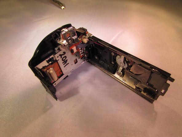

  6. Panasonic SDR H-100 Zoom Lever Replacement, Rear Cover: crwdns2935265:07crwdnd2935265:01crwdnd2935265:01crwdne2935265:0
    • Unscrew the two black 4 mm screws from metal casing around the motherboard.
  7. Panasonic SDR H-100 Zoom Lever Replacement: crwdns2935265:08crwdnd2935265:01crwdnd2935265:02crwdne2935265:0 Panasonic SDR H-100 Zoom Lever Replacement: crwdns2935265:08crwdnd2935265:02crwdnd2935265:02crwdne2935265:0
    • Remove the black 4 mm screw from the back of the camcorder underneath where the battery would have been.
  8. Panasonic SDR H-100 Zoom Lever Replacement: crwdns2935265:09crwdnd2935265:01crwdnd2935265:03crwdne2935265:0 Panasonic SDR H-100 Zoom Lever Replacement: crwdns2935265:09crwdnd2935265:02crwdnd2935265:03crwdne2935265:0 Panasonic SDR H-100 Zoom Lever Replacement: crwdns2935265:09crwdnd2935265:03crwdnd2935265:03crwdne2935265:0
    • Pull the plastic cover on the back out and up slightly until the back feels like it’s free, then pull back on the plastic (The top cover piece and back will be detached).

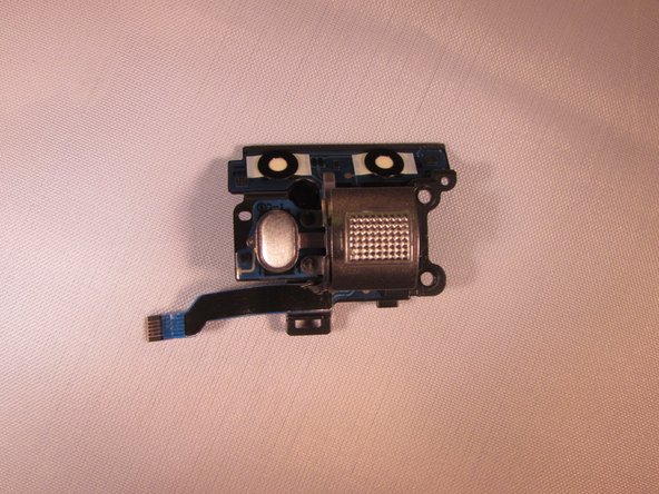

  9. Panasonic SDR H-100 Zoom Lever Replacement, Zoom Lever: crwdns2935265:010crwdnd2935265:01crwdnd2935265:01crwdne2935265:0
    • Grab the plastic piece that covers the back of the camcorder.

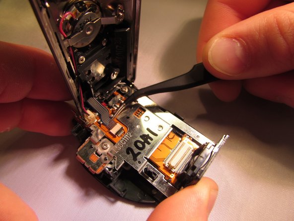

  10. Panasonic SDR H-100 Zoom Lever Replacement: crwdns2935265:011crwdnd2935265:01crwdnd2935265:02crwdne2935265:0 Panasonic SDR H-100 Zoom Lever Replacement: crwdns2935265:011crwdnd2935265:02crwdnd2935265:02crwdne2935265:0
    • Unlock the copper ribbon cable using the blue pry tool.
    • Gently detach the ribbon cable using the tweezers.
  11. Panasonic SDR H-100 Zoom Lever Replacement: crwdns2935265:012crwdnd2935265:01crwdnd2935265:02crwdne2935265:0 Panasonic SDR H-100 Zoom Lever Replacement: crwdns2935265:012crwdnd2935265:02crwdnd2935265:02crwdne2935265:0

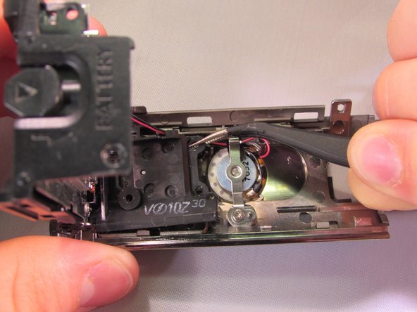

    • Unscrew the four silver 4 mm screws underneath the outer plastic cover.
    • This gives you access to the bottom of the zoom lever.
  12. Panasonic SDR H-100 Zoom Lever Replacement: crwdns2935265:013crwdnd2935265:01crwdnd2935265:02crwdne2935265:0 Panasonic SDR H-100 Zoom Lever Replacement: crwdns2935265:013crwdnd2935265:02crwdnd2935265:02crwdne2935265:0
    • Using tweezers, pull on the black piece that is connected to the underside of the zoom lever while also pushing the back piece at an angle.
    • Do not disconnect the red and black wires while you are doing this.
    • Replace with new zoom lever.
