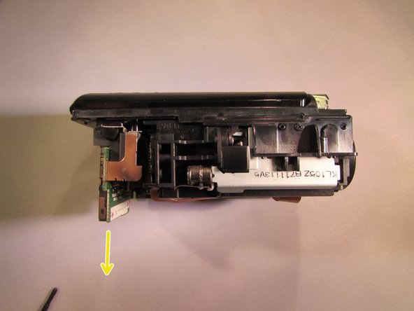

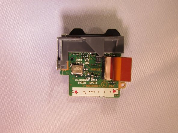

  15. Panasonic SDR H-100 SD Card Slot Replacement, SD Card Slot: crwdns2935265:016crwdnd2935265:01crwdnd2935265:01crwdne2935265:0
    • Disconnect the ribbon cable on the back of the SD card slot.
  16. Panasonic SDR H-100 SD Card Slot Replacement: crwdns2935265:017crwdnd2935265:01crwdnd2935265:01crwdne2935265:0
    • Locate the two black 4 mm screws located on the inside of the device and unscrew them.
  17. Panasonic SDR H-100 SD Card Slot Replacement: crwdns2935265:018crwdnd2935265:01crwdnd2935265:03crwdne2935265:0 Panasonic SDR H-100 SD Card Slot Replacement: crwdns2935265:018crwdnd2935265:02crwdnd2935265:03crwdne2935265:0 Panasonic SDR H-100 SD Card Slot Replacement: crwdns2935265:018crwdnd2935265:03crwdnd2935265:03crwdne2935265:0
    • Pull the SD card slot slightly to the side and detach the SD card slot (the SD card slot is ready to be replaced).
