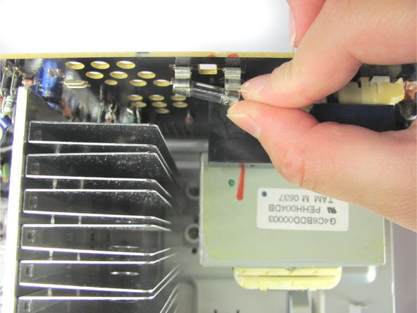

    1. Panasonic SC-PM31 Fuse Replacement, Removing the fuse: crwdns2935265:07crwdnd2935265:01crwdnd2935265:02crwdne2935265:0 Panasonic SC-PM31 Fuse Replacement, Removing the fuse: crwdns2935265:07crwdnd2935265:02crwdnd2935265:02crwdne2935265:0
      • Looking over the top of the tan and green circuit board, locate the fuse.
      • Gently pull the fuse out of the metal claps.
