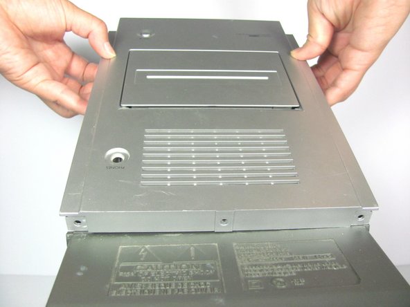

      • Remove the five 9 mm #2 Phillips screws from the side panel nearest the power button.
      • Repeat the process for the opposite panel.
      • Remove the two 15 mm #2 Phillips screws from the back of the top panel.
      • Remove the middle 10mm #2 Phillips screw from the back of the top panel.
    2. Panasonic SC-PM31 CD Player Replacement, Removing the panels: crwdns2935265:02crwdnd2935265:01crwdnd2935265:02crwdne2935265:0 Panasonic SC-PM31 CD Player Replacement, Removing the panels: crwdns2935265:02crwdnd2935265:02crwdnd2935265:02crwdne2935265:0
      • If you do not have a plastic opening tool, you can open the system using your finger. However, if you choose to use your hands, make sure to wear gloves. The panel is very sharp.
      • Swing the back half of the panel slightly away from the unit. Then, starting at the top back corner, slide plastic opening tool through the created gap from back to front. The panel should pop off. Repeat the process on the opposite panel.

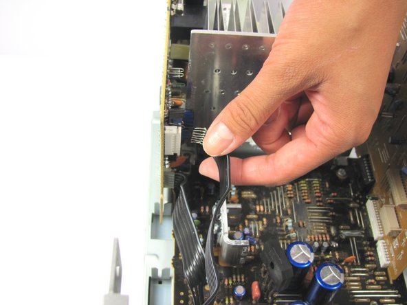

    1. Panasonic SC-PM31 CD Player Replacement, Removing the top black wire: crwdns2935265:05crwdnd2935265:01crwdnd2935265:03crwdne2935265:0 Panasonic SC-PM31 CD Player Replacement, Removing the top black wire: crwdns2935265:05crwdnd2935265:02crwdnd2935265:03crwdne2935265:0 Panasonic SC-PM31 CD Player Replacement, Removing the top black wire: crwdns2935265:05crwdnd2935265:03crwdnd2935265:03crwdne2935265:0
      • Unlike the other ribbon wire connectors, the white connector (in this step only) is not attached to the ribbon wire. It can not, and should not, be pulled out completely.
      • Locate the white connector where the top black ribbon wire attaches to the green and black circuit board.
      • Pinch the tabs on the white connector and pull it partially out.
      • Hold the black ribbon wire directly and pull it the rest of the way out.

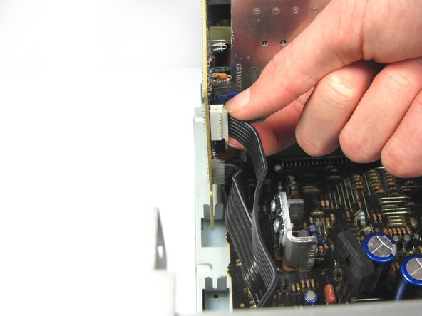

    2. Panasonic SC-PM31 CD Player Replacement: crwdns2935265:06crwdnd2935265:01crwdnd2935265:01crwdne2935265:0
      • Pull the white ribbon cable from its base on the tan circuit board-located on the side of the system opposite the power button.

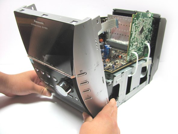

    3. Panasonic SC-PM31 CD Player Replacement, Removing the front panel: crwdns2935265:07crwdnd2935265:01crwdnd2935265:03crwdne2935265:0 Panasonic SC-PM31 CD Player Replacement, Removing the front panel: crwdns2935265:07crwdnd2935265:02crwdnd2935265:03crwdne2935265:0 Panasonic SC-PM31 CD Player Replacement, Removing the front panel: crwdns2935265:07crwdnd2935265:03crwdnd2935265:03crwdne2935265:0

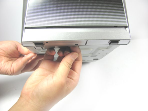

      • On the bottom sides of the front panel, pull the tabs outward to unclip the clasps.
      • Tilt the whole system up and unlock the bottom clasp of the front panel by pulling it toward you.
      • After placing the system back down, pull the front panel toward you to remove it.

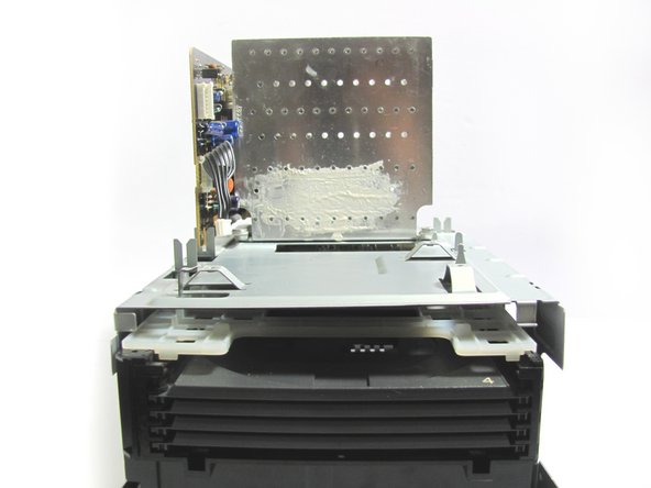

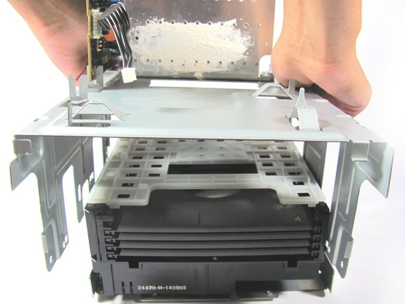

    3. Panasonic SC-PM31 CD Player Replacement, Removing the CD assembly case: crwdns2935265:012crwdnd2935265:01crwdnd2935265:02crwdne2935265:0 Panasonic SC-PM31 CD Player Replacement, Removing the CD assembly case: crwdns2935265:012crwdnd2935265:02crwdnd2935265:02crwdne2935265:0
      • Rotate the device so that the side with the circuit board is facing towards you.
      • Pull the sides of the metal CD assembly case out slightly to disengage the clasps holding the encasing down.
      • Repeat the previous step on the other side.
      • Rotate the device so that the front is facing towards you.
      • Lift the metal CD assembly case up and away from the device.

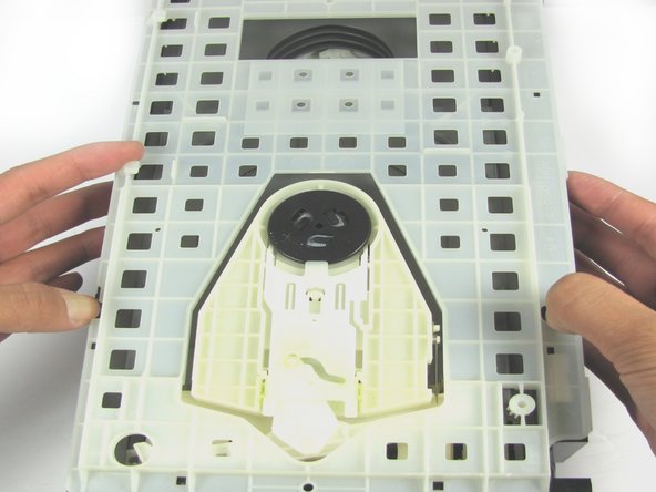

    4. Panasonic SC-PM31 CD Player Replacement, Removing the plastic grid: crwdns2935265:013crwdnd2935265:01crwdnd2935265:02crwdne2935265:0 Panasonic SC-PM31 CD Player Replacement, Removing the plastic grid: crwdns2935265:013crwdnd2935265:02crwdnd2935265:02crwdne2935265:0
      • Push down on the two black clasps and pull the plastic grid towards you.
      • Lift the plastic grid off of the CD assembly.
